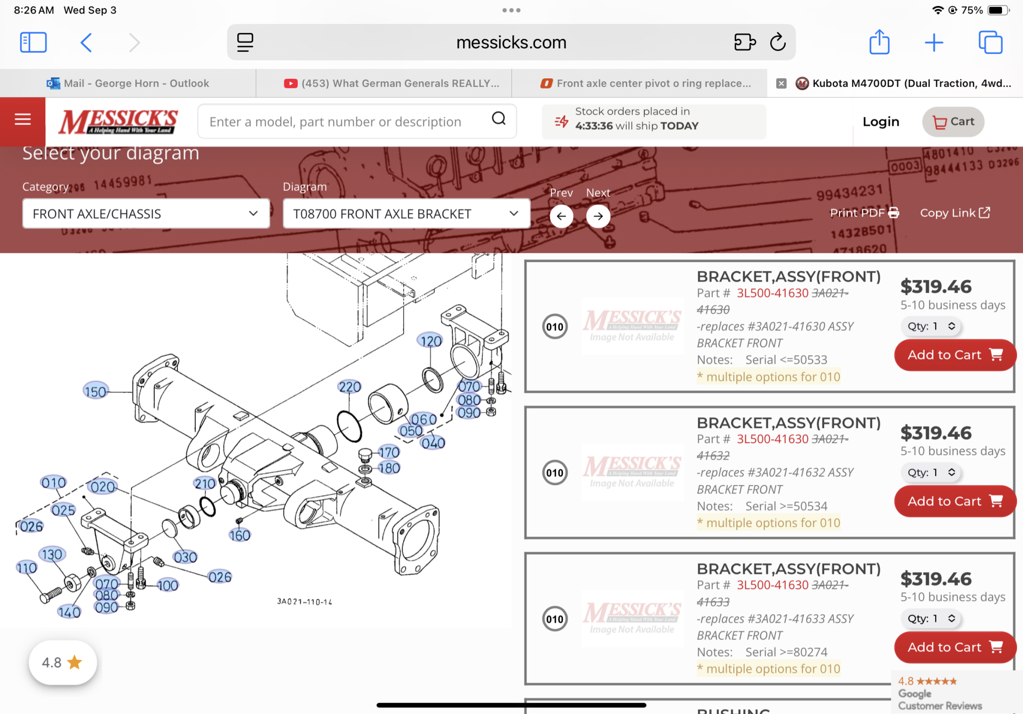

I put grease in the front axle center pivot support of my l2501 4x4 without taking the vent plug out. Heard a pop & grease shot out the back of the housing. Has anyone had to repair the o ring or seal. Any help would be greatly appreciated!!!
33,691
8,909
Just a single O-ring, no seals.
Easy, lift the front tires at least 2" off the ground
Then remove the six bolts holding the front and rear carrier.
Drop the axle down the 2" then remove the front carrier.
Inspect the carrier for cracks.
Replace O-ring and then reverse the process.

It only take one shot to pop the O-ring out of this setup.
