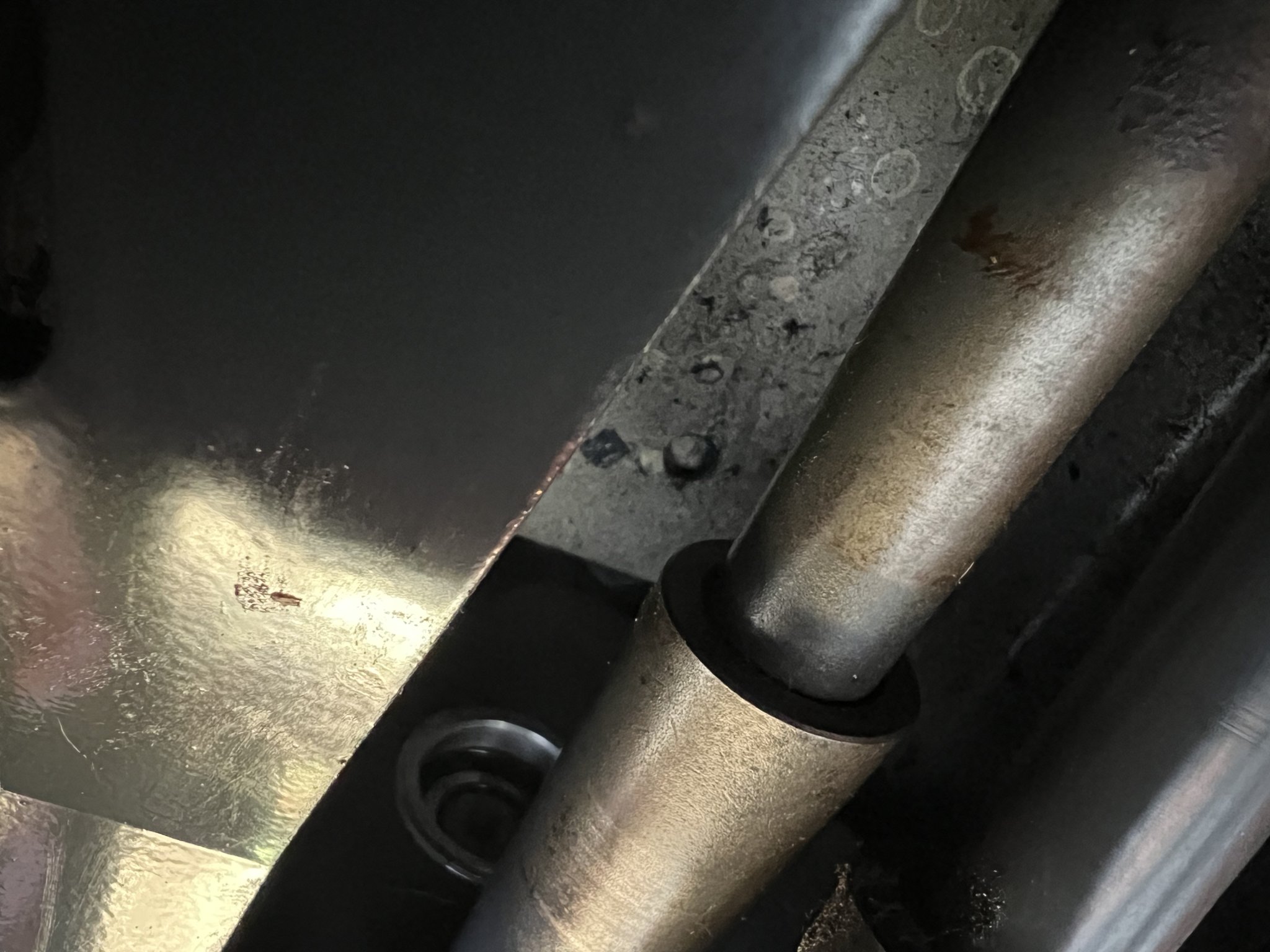

I have a widowed friend who is trying to sell her late husbands b2320 tractor. it was used all summer cutting grass and her son had it out the last week of November (we live in western Pa.). he noticed a severe hydraulic oil leak and parked it in the barn. I checked it out and from underneath, above the output shaft, where it comes out of the clutch housing, it appears that a freeze plug is missing. question ; 1. is this a freeze plug? 2. can this plug be purchased and tapped back in with a block of wood or does it need to be pressed in. thanks for any help.

sorry its a bad picture but the hole that you see above the shaft is in the clutch housing
Csnt tell anythimg from the picture but Welch plugs are used in many castings including transmissions.
Their purpose is not freeze protection - its to close the holes left when the sand cores used in the casting process are removed.

From your picture I think you need part #6A100-12180, looks to be rubber or rubber coated, from parts picture.

It is not a freeze plug, seals a bearing bore.

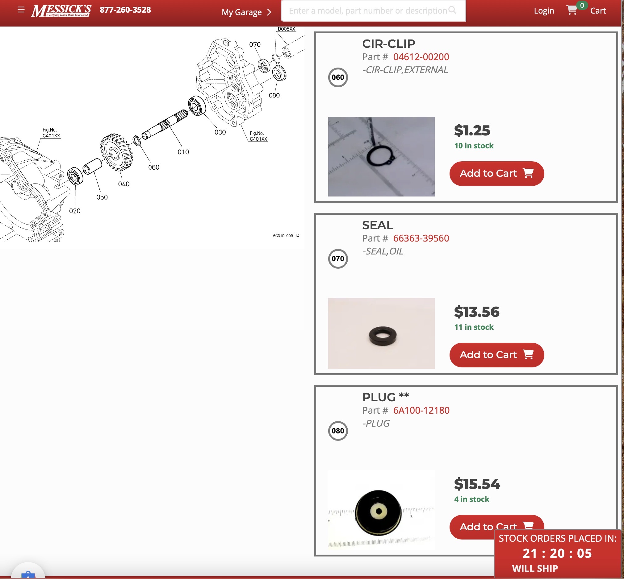

I looked at Messicks parts for B2320 and see there are several versions including one they call dual traction. I think it would help to know which Model of B2320 you have. The only thing I could find close to a plug is number 080. It is hard to tell from the exploded view if this goes in the location in your photo or not.
NOTE: I picked one or two different sub models of B2320 so please verify if this plug is what your needing.

Messick's has 4 in stock so it must be fairly common.

It seems to fit all the versions

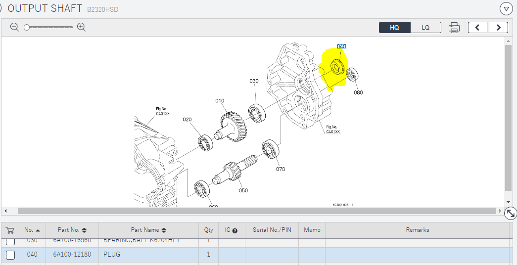

By the looks of the picture it appears you have a HST, if it's not then there is a different plug that fits it.
