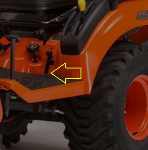

This is the slot where it was found. Just sitting in the bottom of slot. I looked a some parts breakdown photos of the area where the bracket was sitting and I don't see this bracket in any diagrams.

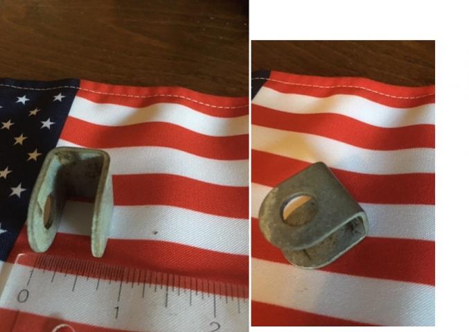

Here's the little bracket or piece I found. It was found at the bottom of the slot for the axle lock foot lever. I didn't see anything obvious to attach it to looking around the foot linkage/slot where this bracket may have come from.

That bracket does not look new enough or clean enough to fit that tractor, been working on anything else lately?

That should be on your ROPS where it folds, the threaded end of the knob goes through the hole and it acts like a spring clip to keep the knob from vibrating out.

Thanks!
I keep the ROP down so it makes sense it could have fallen off. And the ROPs knob is broken too.
That piece must have bounced up off the floorboard and landed in the axle lock shaft.
PS. Regarding "looking too clean" - that photo was not of my tractor - I just grabbed it off a Kubota brochure just to show location.
