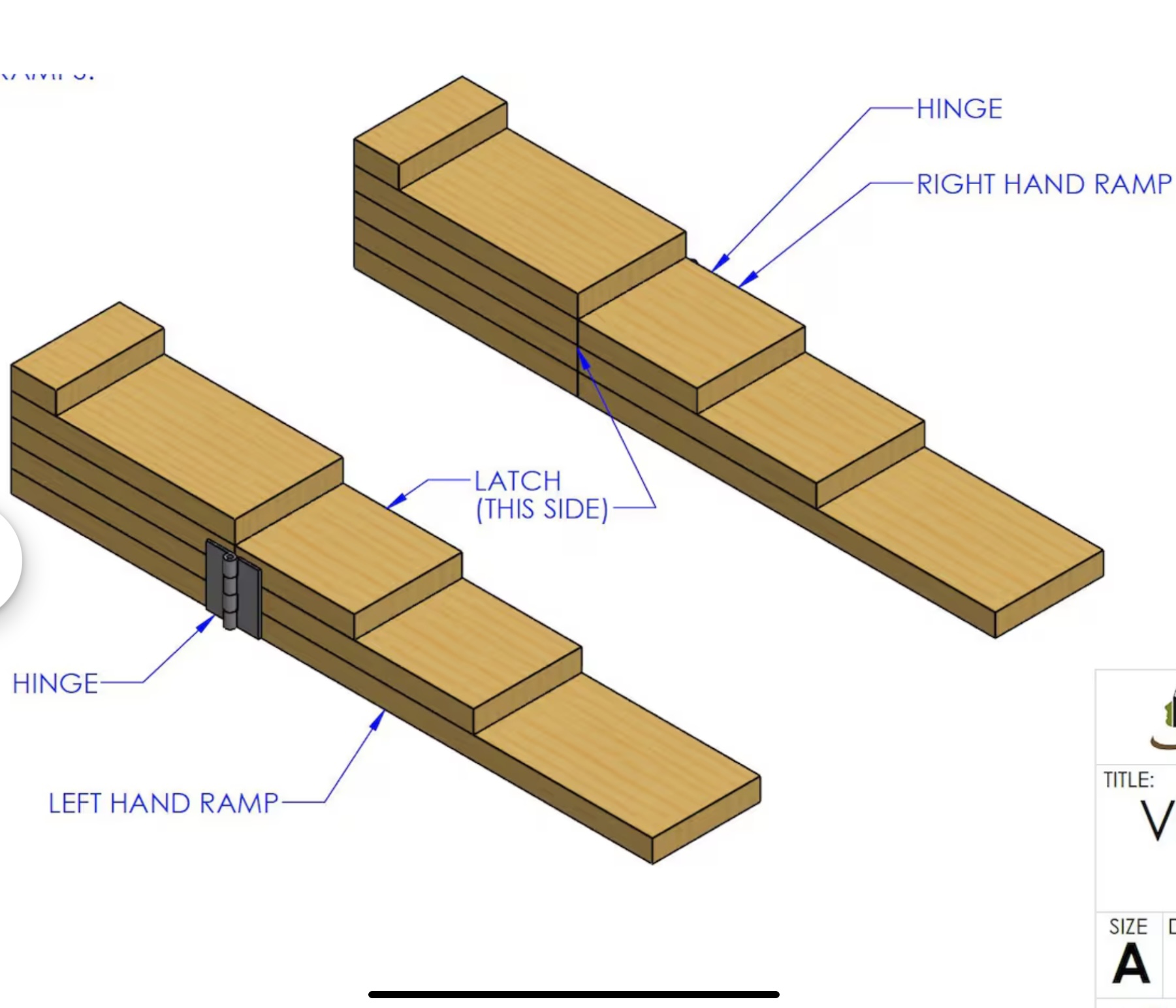

DON’T TRUST PLASTIC ramps! And be suspicious of foreign-made welds that don’t have good penetration.
Make your own out of boards … Pine is fine. (NOT particle-board or MDF)

BTW… when I made my “board” ramps…. I saw no need to use hinges and latches. I just made them in two sections each. This allows the lower sections to be moved out of the way if I need to slide under the vehicle with the creeper.
I assembled the boards using deck screws. And chamfered the leading edges. And attached old seat belt webbing (actually boat trailer winch-strap) to the sides of each so I can easily carry them around.
It was a cheap way to have a durable, trustworthy set of ramps using lumber left-over from other projects. (and with the low “air-dams” beneath the front bumpers of cars these days…the first/lowest board is a bit longer so the air-dam/bumper doesn’t “drag” on the ramps….like so many commercial ramps do these days.)

Personally, I wouldn't use the plastic ones on anything but a flat, paved surface. I use them for quick services on the cars. But that is only 2 wheels. For 4 wheels I would use 2x10 planks bolted together. Similar to what is posted above.
