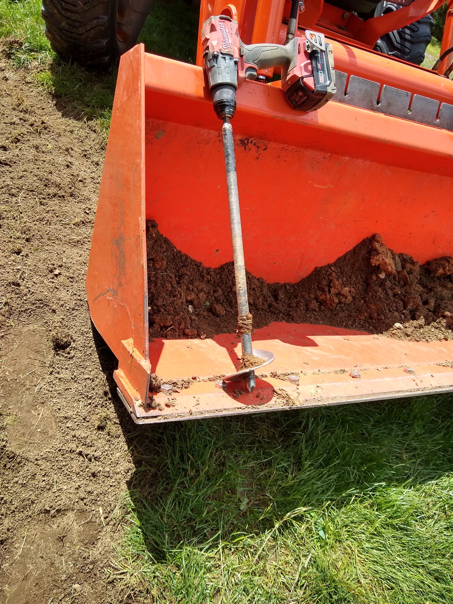

Do you have a 3rd function to hook up hydraulics? How does that mount to the bucket? 😝

Made this years ago. It came out of mothballs today and saved me an awful lot of work. Similar augers can be found in stores.
That looks just like fence corner post anchors we use and it takes a man on each end of a bar to screw them into ground.

My wife bought a set of three of those augers from Amazon. I was amazed at the different things you can do with them. We do a lot of raised bed gardens and I mix the dirt in a large dump bed cart. Normally I used one of those tiny two stroke rototillers in the cart. For the most part, that was like trying to screw a Cougar in a phone booth. This little drill auger took little effort and did an outstanding job.

It started life (at least I think it did) as an anchor for office trailers. There were a bunch of them in our warehouse. It was modified a bit and a rod coupling was welded on the top so the drill has flats to grab. It's a very useful tool for planting. Depending upon what's encountered a side handle is required sometimes.
The original application was to loosen up the fill/soil under our basement slab so I could install a Radon system. The directions were to remove about a 5-gallon bucket full of fill from under the slab to create an air space. This had to be done through a 4-1/2" hole I cored in the slab. The auger was a better approach than a digging iron and it allowed reaching to the sides to loosen the material. Removal was done by scooping big pieces with my hand and smaller ones with the shop vac.
