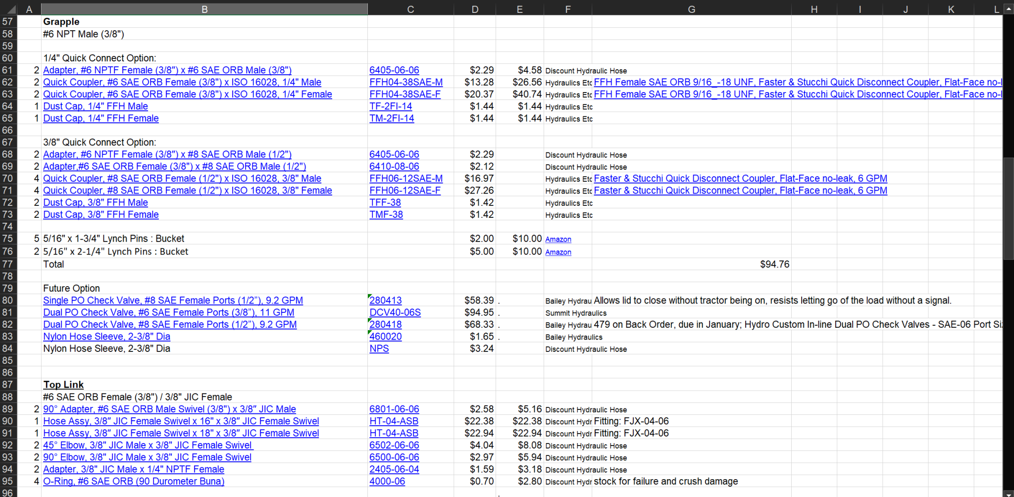

I made a spreadsheet to help keep track of hydraulic plumbing plans, I do not know how people keep that all straight otherwise...SPAM In A Can if there's a plan, otherwise pray it don't spray! :ROFLMAO:

I put a plan in a spreadsheet ordered by part number. For me, I added (1) to the cart as adding multiples didn't hold qty, then I adjusted all quantities in the cart at the same time.
