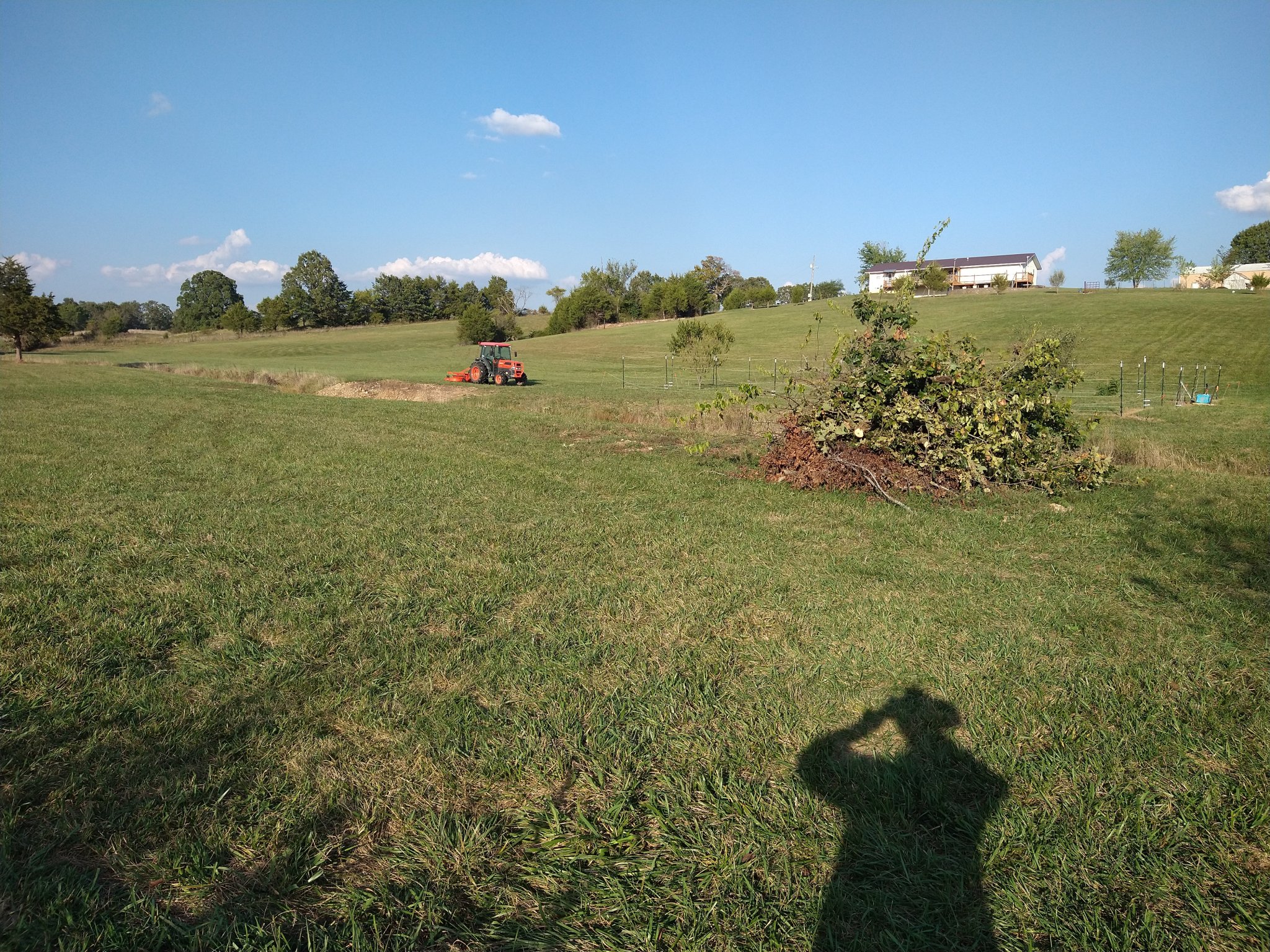

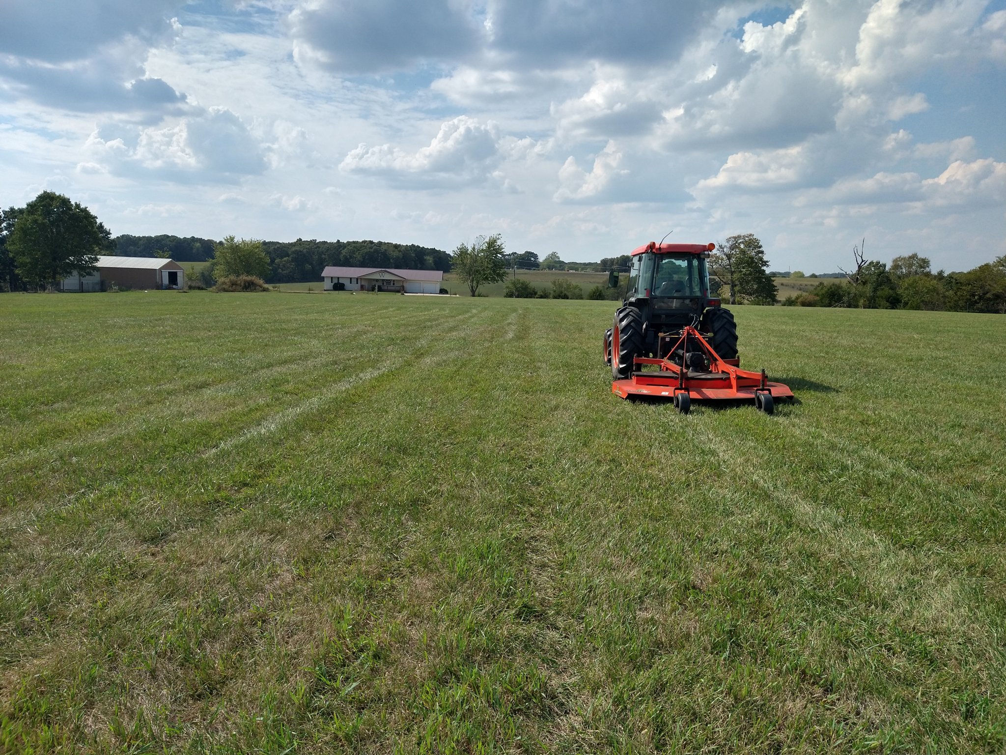

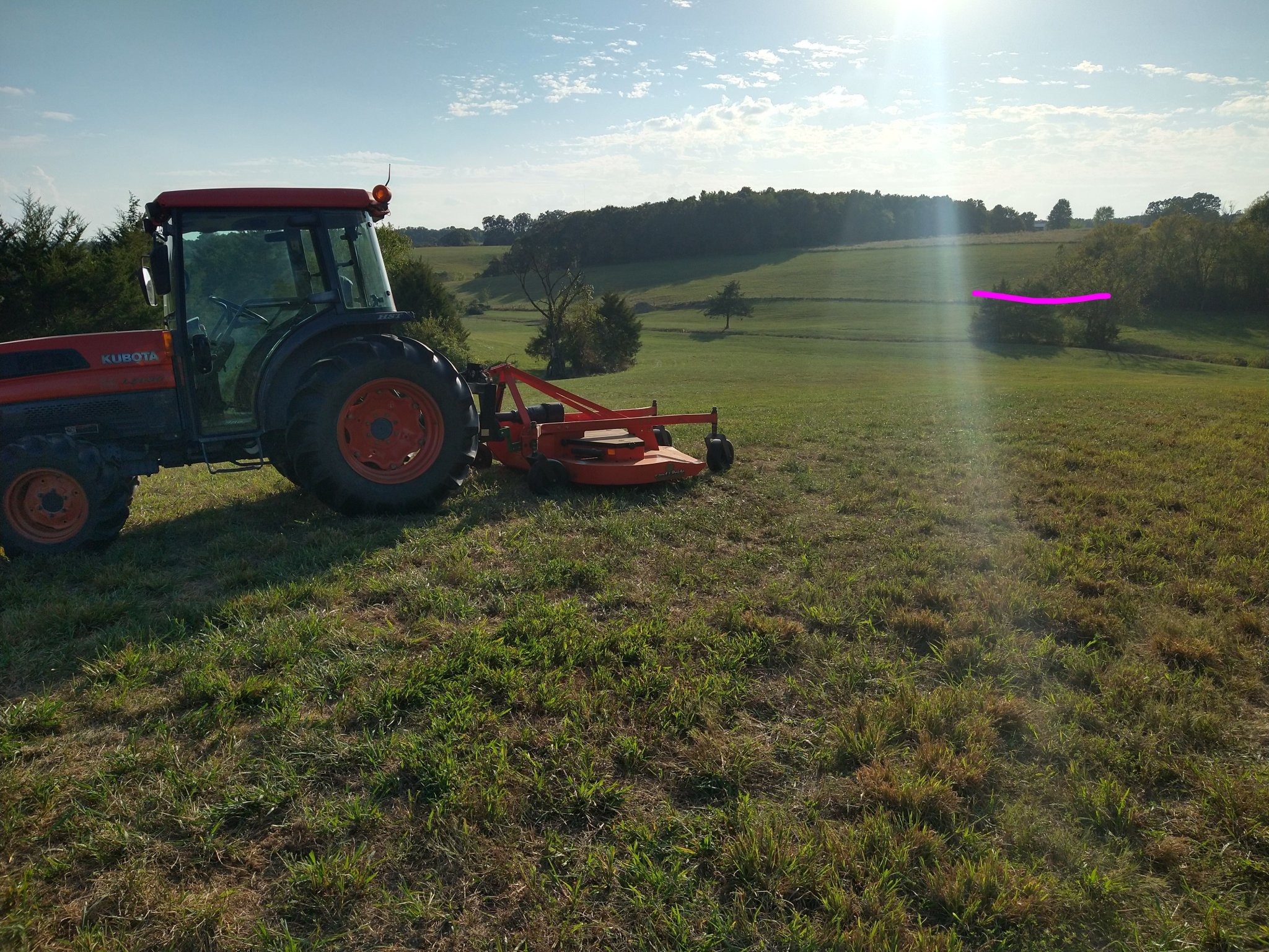

I have a Land Pride rotary cutter and a Land Pride finish mower (rear discharge - 60 inch), and it cuts like a lawn mower. It is Quick Hitch compatible - easy on/off. It also is quiet and fully supported by four wheels. The Chinese imports start around $1,500 for a 48 inch mower, and the USA made mowers start around $3,000.
One last thing, I have been surprised by how well my rotary cutter cuts my well kept field even with blades that have some wear and tear from reclaiming several fields (full of tractor hood high weeds, lots of small privet, 8 foot high multiflora rose hedges and the expected rocks, fallen limbs and etc.).

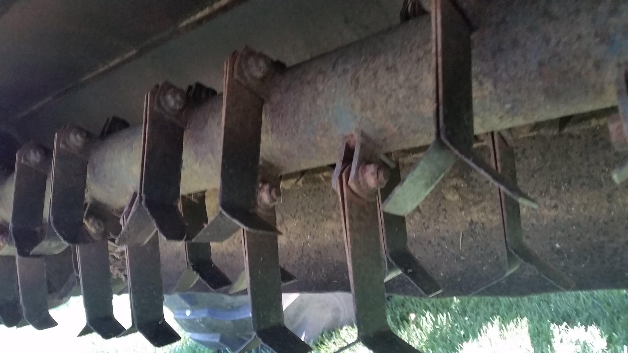

As mentioned a flail mower is not a finish mower. I think he was insinuating a flail will leave a cut not comparable to a finish mower, not sure, only guessing.

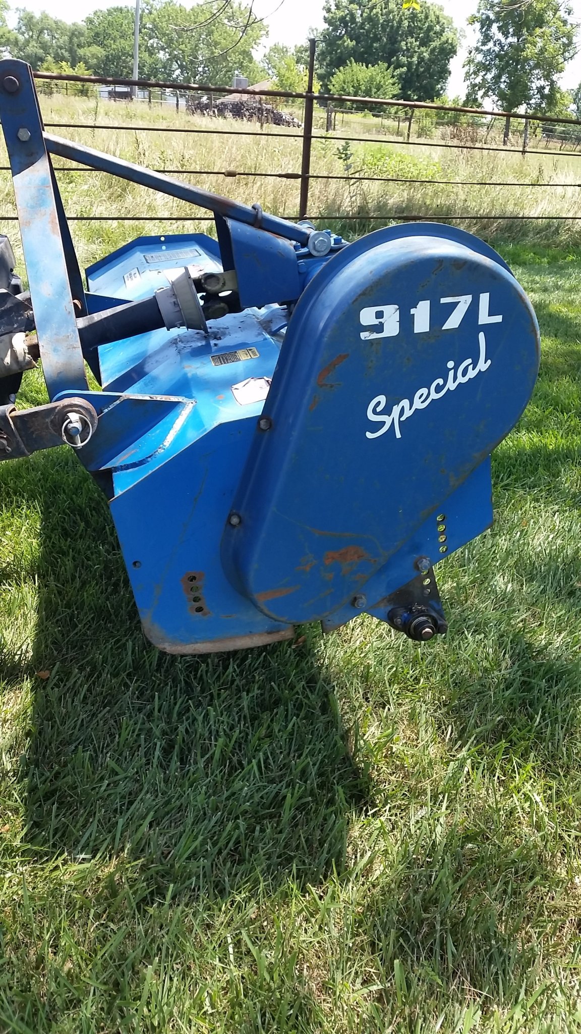

My experience is a flail mower ( have "Y" flails on mine) and I can cut grass/weeds etc. and when run over one time it looks like it was cut with a Lawn boy push mower. I have a 5', 6' and 7'. bought the all used, but they are fairly simple to work on. If flails are in good condition, gearbox and belts work, it'll cut. Here's the 5 footer.
