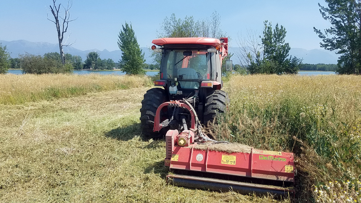

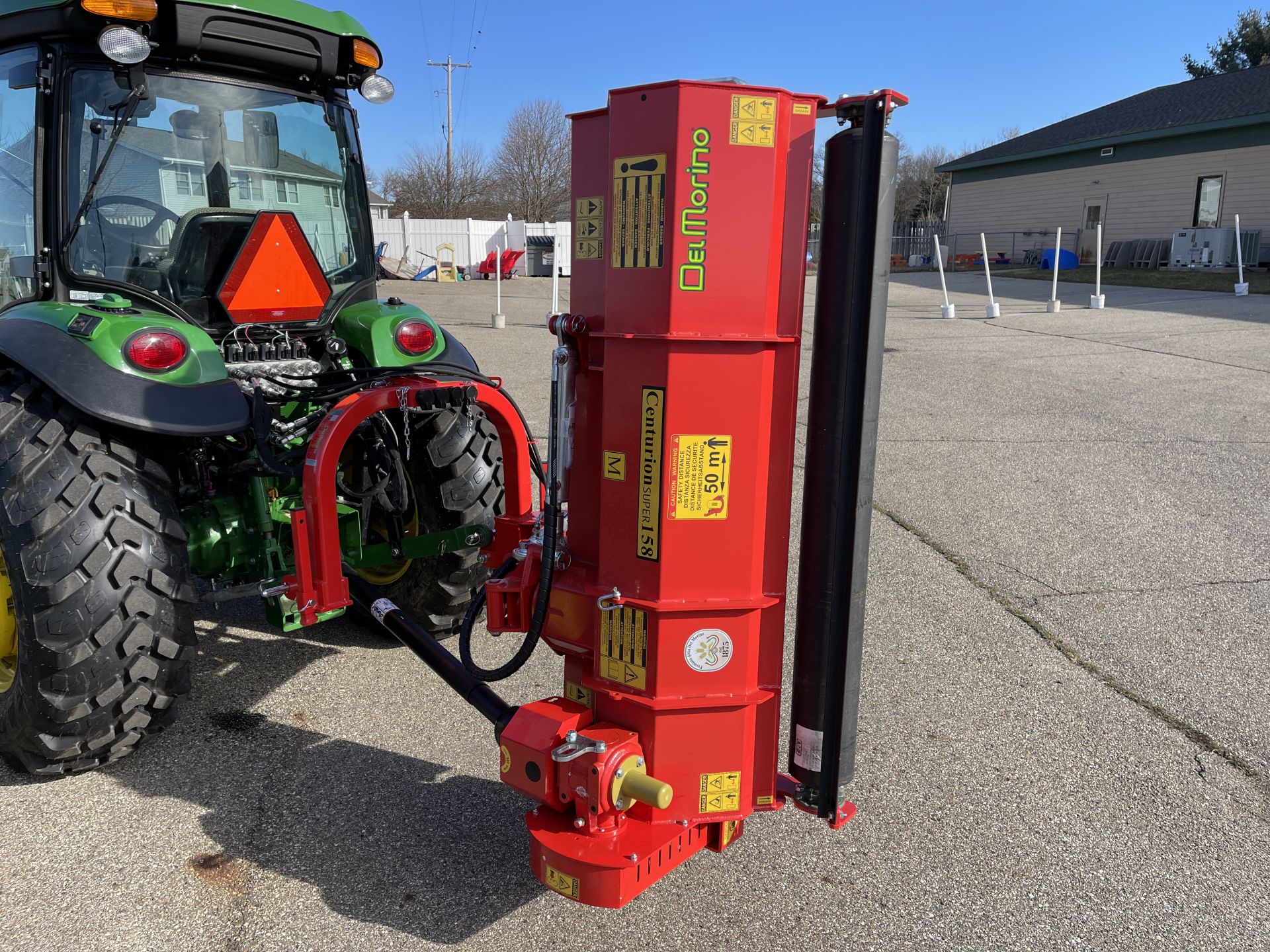

Flail all day long. I have a Land Pride 12ft folding cutter, a Land Pride 7ft rotary cutter and a Del Morino 5ft flail with hydraulic cutting head offset and rotation. The flail is just so useful and versatile a tool and I'm most likely going to sell the RCR1884 this spring since it's just not that useful for me, particularly after I bought the RC3712 which is way faster than the 7ft cutter.
You can float the flail over the ground if necessary to top taller stuff, in fact, that's exactly how many European farmers use their flails. Also, if you need to widen a trail, you can rotate the cutting head and trim hedges or bushes back.
