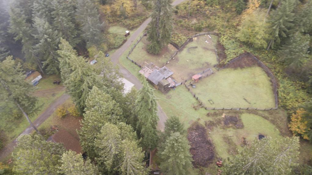

Before I bought my B2601 with R4s I was in the same boat as you. Most of my property is on the side of a hill (10 acres) so wanted the tractor weight to be as low to the ground as possible with enough ground clearance to get around in the woods and to mow my up to 20 degree trails, however trail crossings at 15 degrees scared the hell out of me so I added 2 1/2" spacers and went with more rear ballast. Now I probably feel more confident than I should be. I am able to grapple 22 inch x 12 FT Hemlock around but no doubt the B2650 would do better there.
