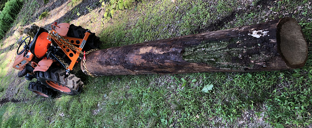

Congrats @tomtsled, on the b7100, I have a similar b7100 which came woth the 4 way hydraulic plow. It works fairly well for plowing except when the plow is angled and loaded up, then the front end gets pushed around, rendering the steering wheel nearly useless. You will quickly learn to overcome this with the independents steering brakes. the machine will likely run out of traction before it runs out of horsepower plowing snow. Even with 350ishlbs hanging off the 3 point and cobbled chains on the rear I still run out of traction plowing my 400' driveway that goes uphill.on both ends. I also use mine for skidding logs and with a simple homemade trailer hitch on the 3ph with a integrated grab hook and a chain with a slip hook I haven't found a log I couldn't skid using the 3ph so long as I can get one end off the ground. To overcome the logs I couldn't get one end up on I fabricobbked a (sketchy looking but functional) FEL for the front end using the plow hydraulic valve plow fram and aquired steel. Now if I can't lift it with the 3ph I just buck it up on site and take it out a few pieces at a time, slower but it gets the job done.. next project is a set of forks for my loader. You are going to like the simplicity and reliability of that little billybgoat of a tractor. As others have said religiously keep an eye on your fan belt radiator and coolant level. I recently replaced my fan belt, hoses and most of the coolant in my machine hoses and belt where probably original. The hoses are an easy find on Messicks site and the belt has a napa cross-reference that I can't remember right now but someone posted on another thread just the other day I had already got mine from messicks.

You might want to consider a 3PT log skidder attachment for the machine. They are quite handy for moving logs a distance.
