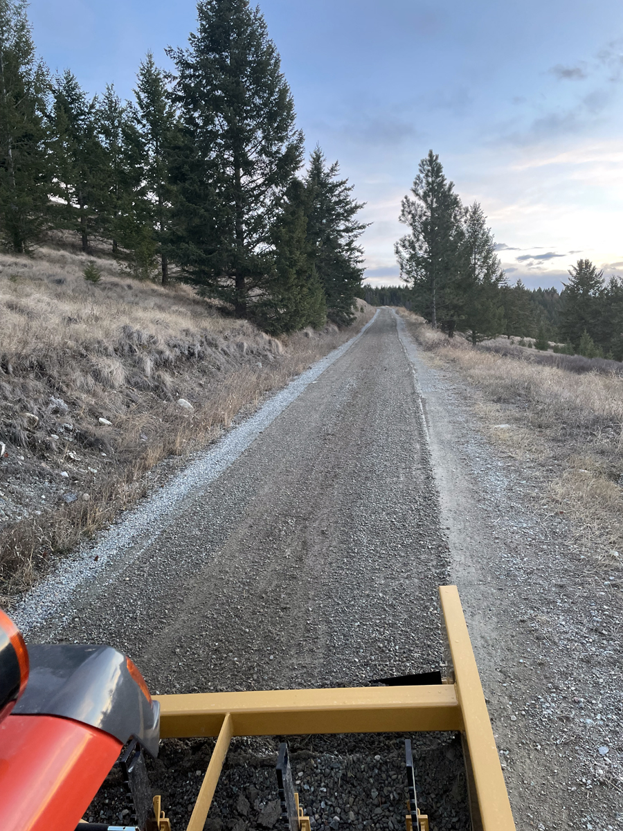

I'm not sure if it's set up optimally for what we're trying to do but after spending the better part of six hours this past spring trying to get it decent using a rear blade, this implement is way better. We didn't end up with tons of gravel where we don't need it and there's none of the constant correcting where you push the gravel in one area and then have to push a bunch of it back to another area.
I think it's going to be the perfect tool for gravel driveway maintenance. I realize that many know this already but I'm just learning it for myself. I ordered the model with scarifiers because it's better to have and not need vs. not have.

When I am first getting after a driveway I drop the rippers and tip the land plane forward a bit so the rear blade is out of play. After a few passes you have broken up the compact gravel a few inches deep. Then raise the rippers and adjust the land plane so it rides perfectly flat after it is loaded up with gravel. This will give you what amount to a brand new driveway. Over the next few years you can skip the ripper step until you start seeing potholes develop.

Thanks for sharing that. I'll most likely try that approach if we continue to have warmer temps and rain since the ground will be softer. If we get into a freeze I'll have to wait until the spring.

My experience…if it’s wet or you have have too much running over the top while running it flat like I do often, I’ll make a final pass with just the rear blade riding over the ground to make it perfectly smooth and taking the ripples out. If that makes sense.

Fwiw, I never use the scarifiers on our gravel road or my driveway. It's unnecessary and requires a lot more work to get the road back in shape according to all I've heard. You want it to be packed hard.
Fwiw, that was the recommendation from the guy who dropped mine off from the dealer. He was dead right. One thing you'll notice is that you only need to loosen the top layer a bit. Then, driving when it is a little wet will make it harden. It feels done once the tractor is riding smooth over it without any bouncing.
I've been maintaining our "unmaintained by the county" up to the house of the other guy's house who works on the road. More times a little bit of time in between makes a big improvement compared to more passes in one day. In other words, a couple of passes in one day from each direction repeating in a week or two is better than a lot of passes in one day. You want the vehicles to pack it down if you have fines. If I had a roller, I guess I could pack it, but the vehicles do a good job in a day or two.

It would be, but assuming your base is like mine, it will pack down in a couple of days. Even my driveway does. But, if you run scarifiers, it's whole different level.

Wow that’s one long driveway
That's about 1/3 of the driveway. The gravel part is about 180 yards long, and the asphalt section is close to 175 yards or so.
