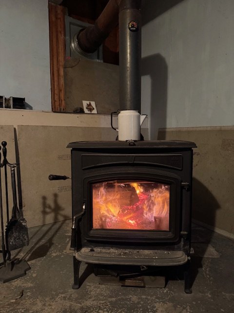

I found Rockford Chimney Supply to be extremely helpful (I had lots of questions) and reasonably priced (including shipping). I ended up with an insulated liner and cap down to my wood stove after discovering some issues with my old flue liner which was way oversized and led to significant creosote build up each year. I am now using my new liner and it draws a lot better so so far so good.

View attachment 143444 View attachment 143444
True. And it’s very difficult to properly clean an unlined masonry chimney. With a flue liner, it’s easy to open the stovetop damper and run the brush down from the top. All of the soot and creosote goes into the stove for easy removal. Without a liner, the dove has to be slid out of the fireplace opening to remove the sweepings.
