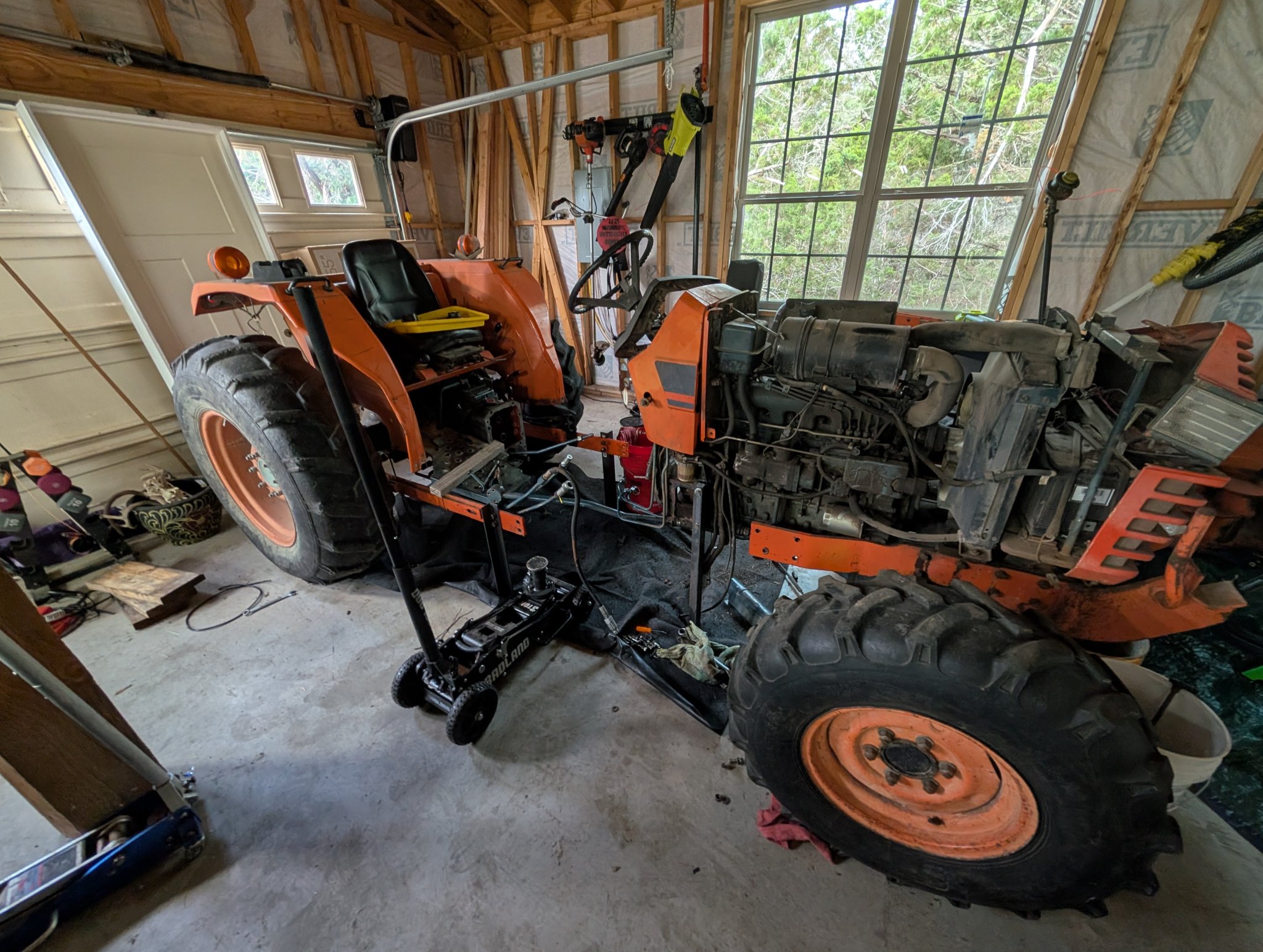

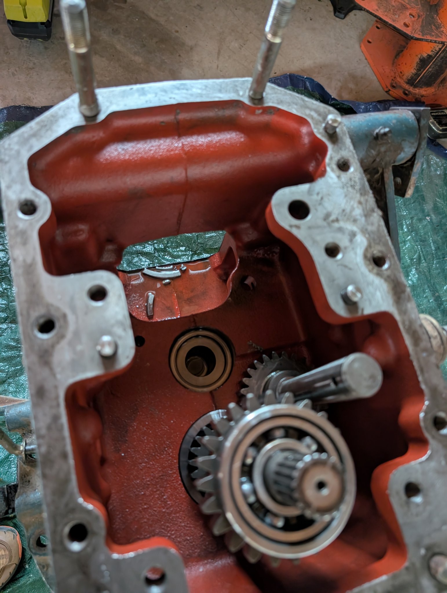

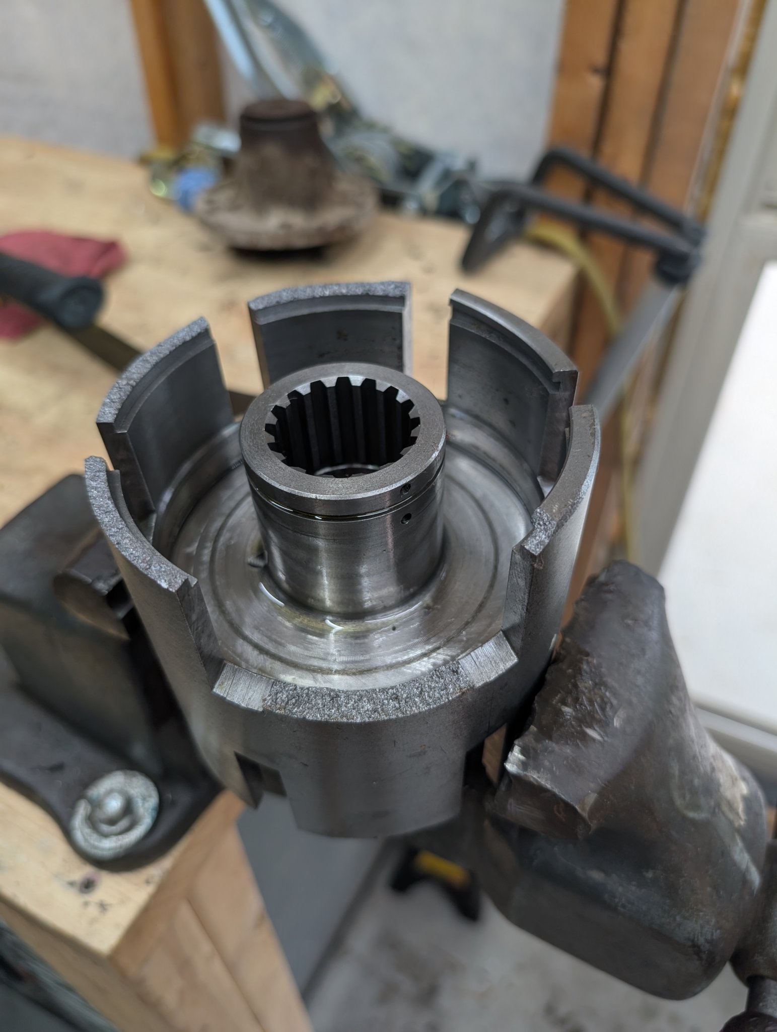

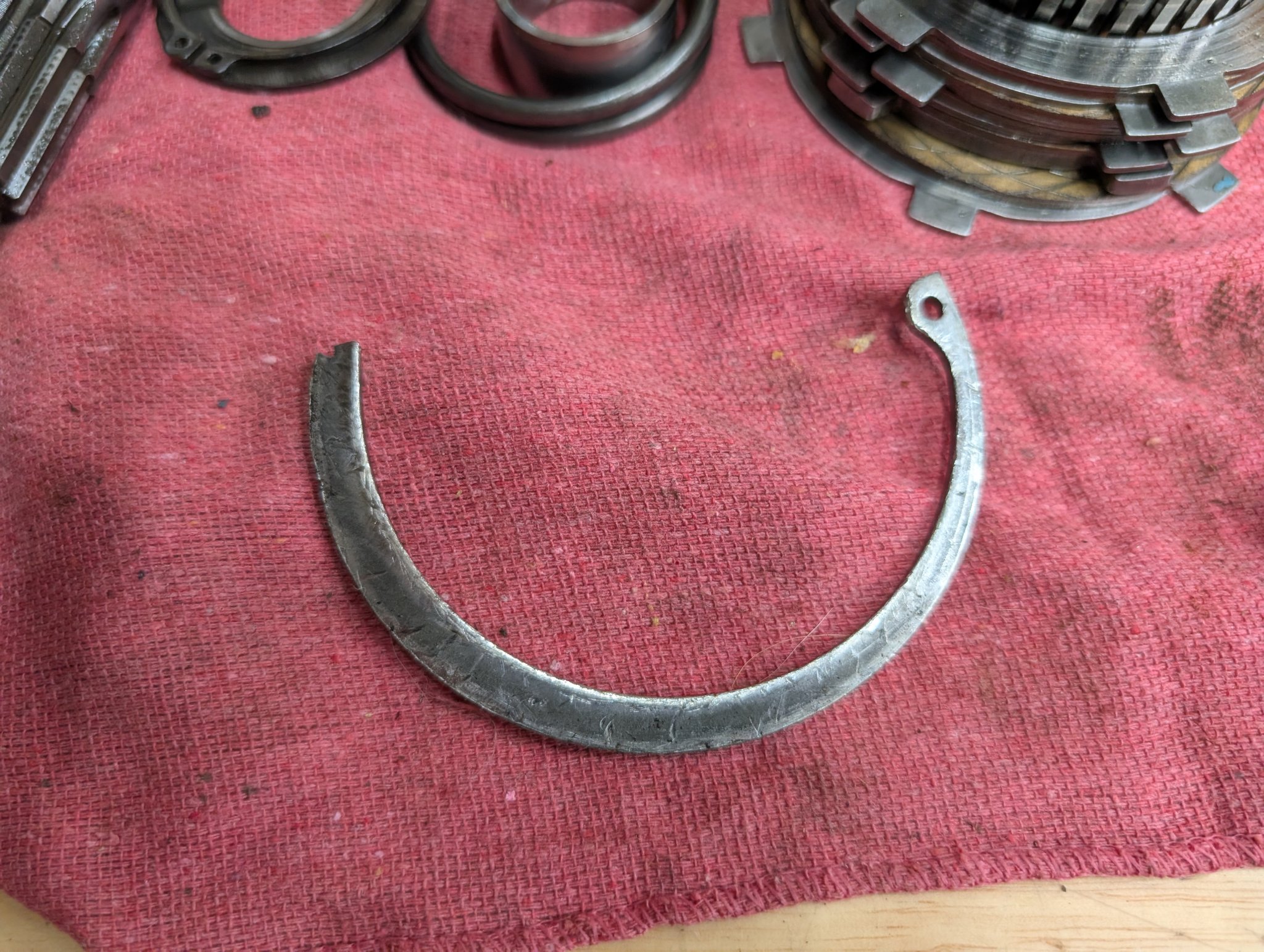

Wondering if anyone has found other sources for parts unavailable from Kubota. Bought a L4150DT with loader for $3000 a couple months ago; it moved forward on under load but tranny would grind and wouldn't go into reverse. Was able to finally split and the hydraulic shuttle 2 ND Transmission case clutch (32530-20240) has several missing pieces from one of the larger c rings failing. Was able to find the c ring on eBay for $70! Can't find a replacement case clutch. Called several Kubotas and part is nowhere to be found (even though several show available online). Are there go to part out vendors you all are able to find? At this point, I may just have to install the broken case clutch and hope it holds with the new c ring. Thank you!

'Mountainman" came through with the part including shaft and discs. Maybe I'll be the last person to have all parts except the workable case enclosure. First time tractor split and can't show enough appreciation for the support. From the above post, checked in on Associated Tractor and TractorPatrsAsap. First tractor split and you all have me confidence to continue.
