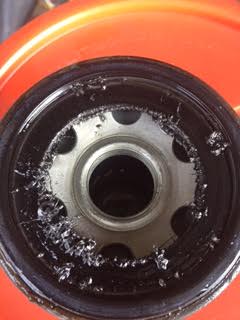

Purchased a 2011 L3200 HST with 155 hours on it.
Outside of taking it off the trailer i didn't drive it much because it had the factory filters on it.
Changed all the fluids and filters.
I have included a picture of the filter. There was a lot of of metal shavings in the suction filter.
I'm worried that there is more metal floating around the HST system that the filter couldn't pick up.
Should I replace the suction filter again after a few more hours to see if anything else gets caught?
If I do that with the HST system at capacity fluid level will a lot of fluid start pouring out?
Finally I'm completely new to HST systems. Mine sounds very whinny when I'm driving...is that normal?
THAT AINT GOOD - 150+ hours and original filters????? mmmmmmmmmmm
Those shaving have been there a while!
Probably not - that filter has been worked hard!
Should I replace the suction filter again after a few more hours to see if anything else gets caught? HAVE you checked the screen filter - this is the one that you clean?
To change out the filter - if you have the new one ready will not loose a lot - maybe 6-8 oz tops.....what EVER you do - leave the dipstick IN!
WHINE? what whine????:rolleyes: The one thing that you will hear is whine...... now there is a fix ....but it will cost you a few $$$$ ........but your tractor will love you for it and you'll not hear the whine much after....

The whine is probably just the normal HST whine ( Bulldog has a good take on it ), but it could be exaggerated by wear from not doing the first and second service on it. :(
I personally would pull the filter off and replace it about 20 hours more, it is highly unlikely, but if you do get more metal in there, your probably looking at a HST rebuild at some point.

I figured since Hokie had pretty much covered the bases I would poke just a little.
I agree with you Wolfman. Just for piece of mind I would change the filter again to see if the problem still exist. Since the oil and filter have been changed it should be clean unless it really has a problem. Those metal shavings and fine metal is why (in my opinion) the 50 hr service is the most important service of the tractors life.
