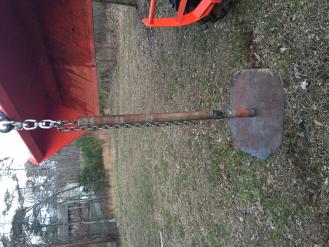

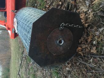

I didn't want to spend any more money than I had to to unroll the 1k feet of fence my wife and I are doing this week/weekend and maybe next also depending how slow the posts drive in my rocky soil. Those 300 foot rolls of goat and sheep fence are rather heavy.
I rigged this up for the boom pole on my tractor to hopefully make life a little easier and not spend 400 on the unroller from TS.
I only have about 15 bucks in it as I ran out of chain and had to pick up a small piece. I made it from an old piece of heavy wall galv conduit and some scrap plate I had in the yard.
The large bottom plate rotates and the main pole is held by a chain at the bottom to keep it from spinning with the fence.
Sorry for the sideways picture.

I would say that would work pretty ok, if you go slow and steady though I have to ask how your going to pull the fence tight?

IMHO, you would have been better off attaching the wire holder base and pipe directly onto the bucket that way it would not flop around so much. ;)

As wolfman said.
A swinging rotating mass can get dangerous.
Laying fence roll horizontal and two chains on either end would make it easier to manage.
As an added measure to what you have, run two chains on bottom end, fasten to loader or tractor frame. Would keep it from swinging.
We made up a fence tensioner with a pipe and a bunch of hooks made from rebar, and used a come-along to an anchor point.
Steel bar threaded through end of fence and a couple ratchet straps works too.

The unroller actually worked pretty well. I will probably make a few changes to it mostly replacing the bottom chain with a piece a small tube. The chain didn't quite keep the whole thing from spinning like I was trying to avoid. I prefer not to unroll fence with just a chain through as I have had a roll get all tangled up in a chain once. Took forever to get it all unraveled. The fence roll doesn't swing hardly at all. I was running it with the bottom of the fence roll only a few inches off the ground and had the tractor in low.
For stretching the fence I have a home rigged stretcher that I can hook to the draw bar and stretch the fence with the roll still hanging. However, today I put the new winch to work and just stretched the fence with it. More tension control with the winch than just pulling it with the tractor like I have done in the past.
