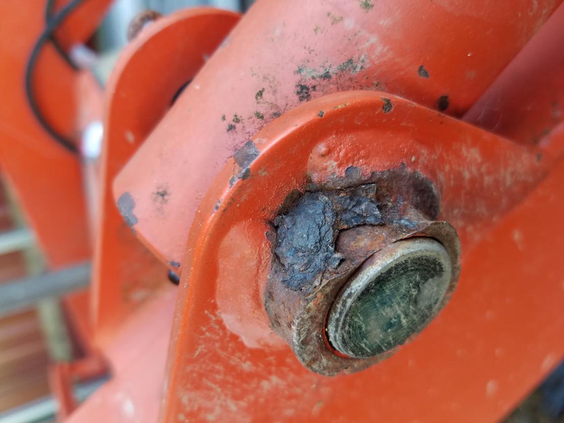

I recently acquired a 1992 L2950. I have questions about the FEL pivots, the bushing are worn. Is there a fix for this?
The base of the joystick pops apart, The ball falls out of the ring around it. Therefore no bucket control for tilting up or down. Is there some sort of fastener on the end of the ball? Looks like a rod or threaded shaft came out the ball but is broken off? 20170519_192846.jpg I would like to order the parts but I dont have the parts voc[/ATTACH]abulary to search properly.

Joystick rod ends are available, go to http://www.kubota.com/part/partsList.aspx and agree to terms an put in your loader number and look at the list of parts and diagrams.
I haven't had a look, but bushes may or may not be available from kubota depending on model, and may need to be sourced by a welding shop, fair bit of work there......
Looks like corrosion from the top, has this been used in a chicken/turkey operation or chemical works? No lube as well.

First thing you need to do is find out which loader you have, the tractor is a L2950, but the loader is something like a LA450A
The ball joint should be P/N 75540-62260
As far as the bushings, your either going to have to make them yourself or have a shop do it.

100 td-I don't know how it was used. It does have rust which I believed was mostly due to being from a coastal area. I'm curious how chicken/turkeys are hard on tractors? I now realize the fel must not have been lubed very often.

Oh,my...looks like the bushings are gonna be project!
Use of tractors in cleaning of chicken/turkey sheds means a build up of bird excrement dust on top of everything which then corrodes, it looks like corrosion has started on the top of your pins, but may have been from the salty environment you mentioned. Lack of lube is also very evident.
My tractor came from a turkey farm..........
