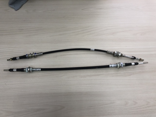

My wife was using our Grand L5740 HSTC-3 tractor yesterday for moving material in the FEL. At some point, the FEL stopped working in the down position and only went up at a snails pace. The curl function was still working as normal. She was smart enough to stop what she was doing in order to avoid any further damage.
When I got home, I started investigating and found the Joy Stick control very lose in the down position, almost as if there was no connection. Thinking that the linkage may have broken, I started following the assembly cables to where they connect to the hydraulic valves and found that the up/down cable was not moving anything. Of course, this was after removing the rear tire and the access panel within the wheel well. I was able to operate the valve manually, so that seemed to confirm that the hydraulics were fine and it was a linkage/cable issue.
I haven't taken apart the cable yet, but have identified the Kubota Part Number as TD270-35252, Loader Valve Lever Assembly Cable.
Here are some of my questions . .
Do these cables just where out / break at times? Is this a relatively normal repair?
How difficult is it to change this cable? Any special tools needed?
Is this a symptom of something else - operator issues? I did purchase the tractor used with approx 400 hours on it. It currently has 540 hours.
The cable is not that expensive - $120, but I want to make sure I'm not getting myself into anything that I may not be able to complete.
Any / all thoughts, suggestions, comments are welcomed!!
