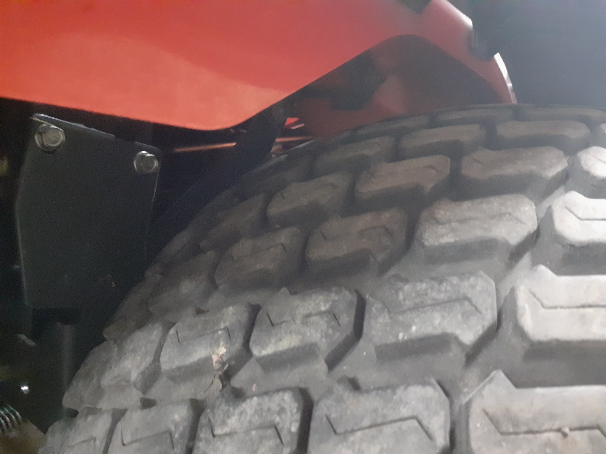

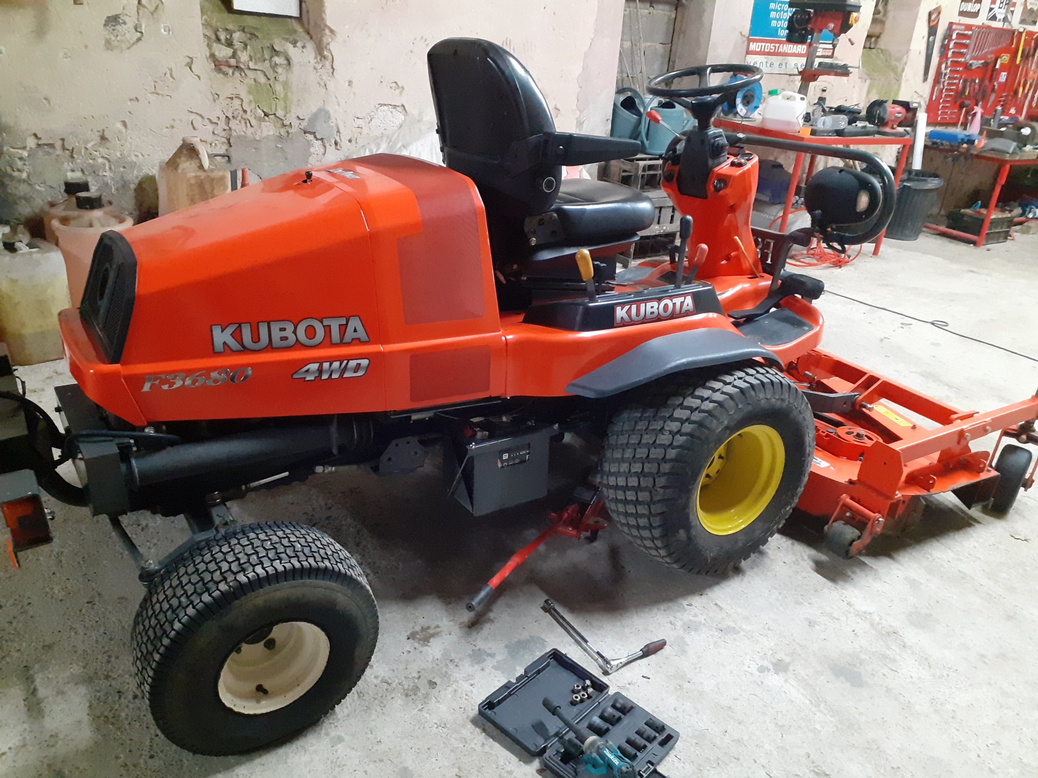

So,my neighboor give me a 26x12x12 from his JD 455 to try on the 3680 and that fit perfectly .so i will buy definitly, i will put highter tyres on the rear too.
