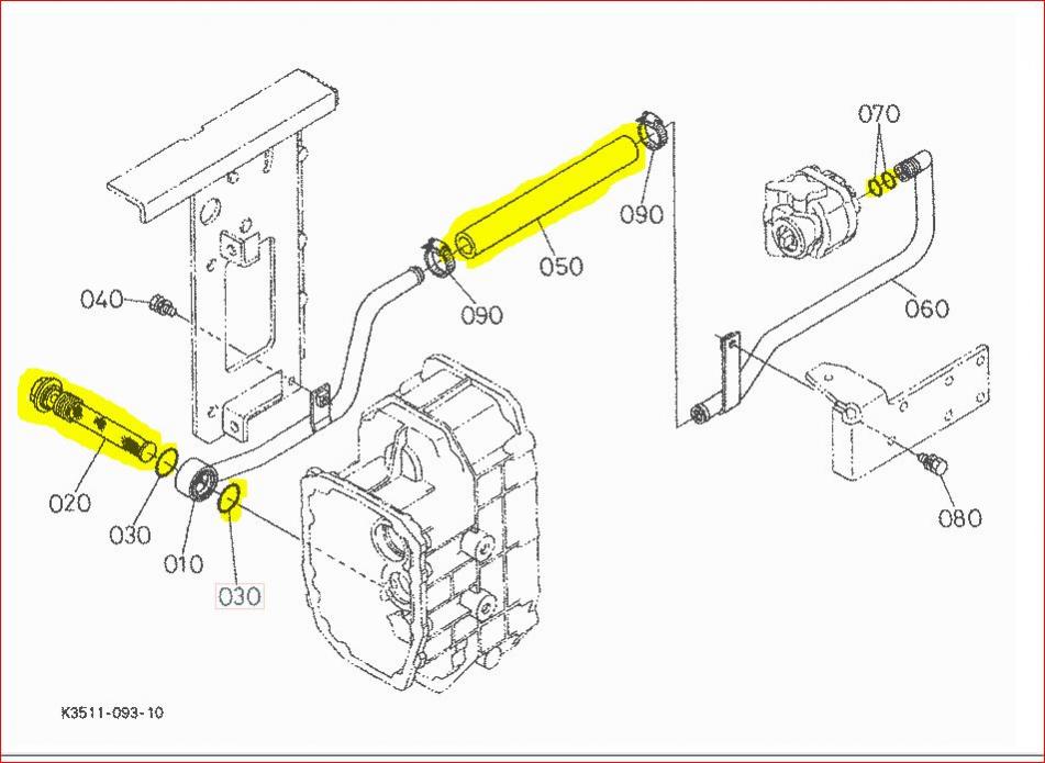

Yes the main Hydraulic pump having a problem will effect the HST pump, They work together on that model.
When was the last time you did a fluid and filter change?

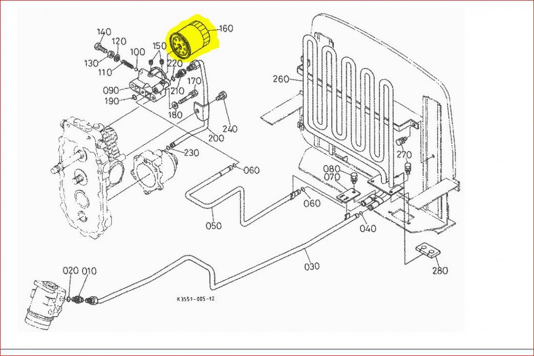

There is 2 filters on that model, a pickup tube filter screen and a spin on filter, if either is getting restricted then that will cause all your problems, also check any rubber hose connections and O-tings on the suction side as they too can cause it to suck air and same issues.
If all of these look good then you are down to a bad hydraulic pump, you can do a pressure check to verify.
