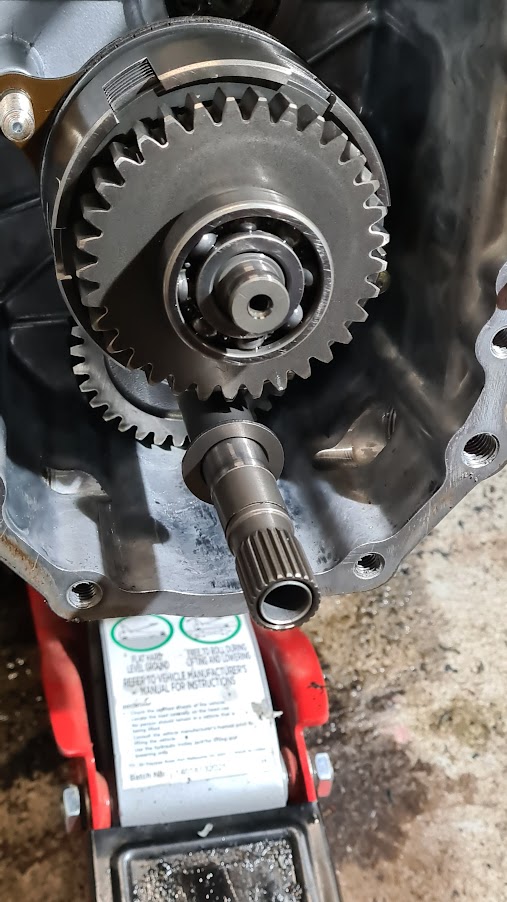

Hi,
While replacing seals on my F2880 mower I encountered a type of washer in the transmission case that appears to be called 3RD SLAST COLLAR 2. It fell off the rear wheel propeller shaft as I opened up the transmission case and I do not know which it goes on. There are 4 radial grooves on it. I was wondering if anybody could advise what way the grooves need to be facing, the front or rear of the mower?
Cheers,
Luka
