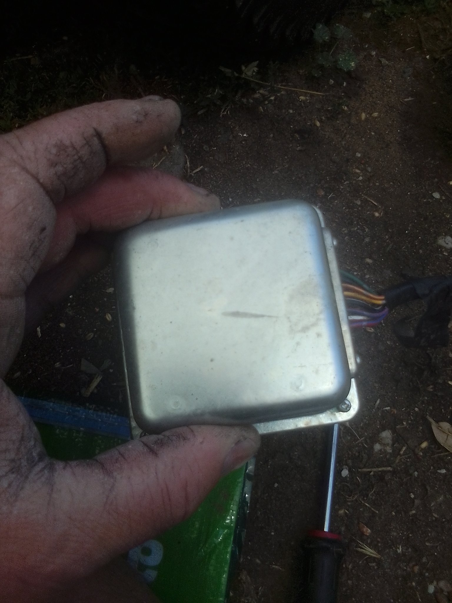

Hi guys i know this is an old post but it is relevant to my current situation if you could please provide me some advice. I thank you in advance.
I have just picked up a f2400 with a d1105 in it and i have no power going to my fuel solenoid or my gauges. The oil and Battery lights light up but not the fuel or temp gauges i have checked all the wires and all seems good i think the problem is the control module the part number that is listed for this machine is 76611-55710 but i can not find any photos to ensure the plug is right. My plug is round i have attached photos of what my unit looks like.
The solenoid works when i put power to it however when it is all wired in i do not get power to it at all. Does the control module power the fuel solenoid? Is there a way to test the control module at all? or am i missing something?
I have been told parts for these machines will be hard to find in Australia as they were all imported and i am finding that this is the case. Is there a way i can by pass the harness and power the solenoid directly on like a toggle switch or similar. Thanks for your time and happy new year.
