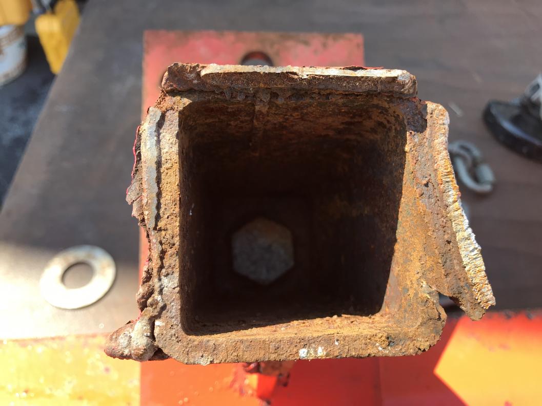

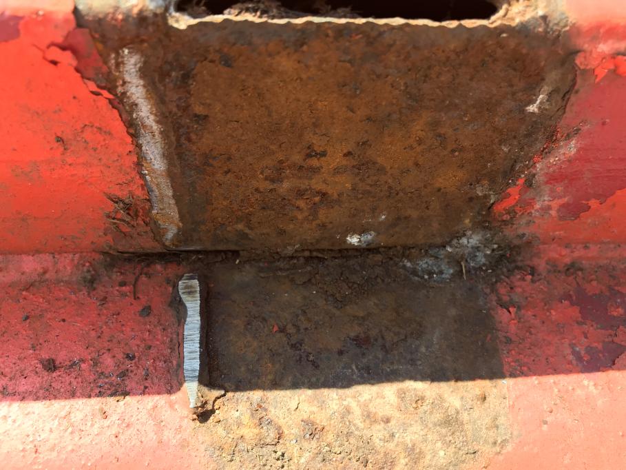

Here's what happened with my 6' TSC blade. The little Ford was using it for snow removal during the last snow. There were only a couple of welds that had any penetration. It's amazing that it lasted for several years before the post ripped off. Repairing it was the first project for the welding table.

Worst factory welds I’ve seen, is this made in the USA? Amazing it lasted you two years
Looks like you’re set up for a quick repair, imagine if you were a customer with no welding abilities.

Maybe if we had not seen good quality, this would be acceptable, but my son's first attempts at welding surpassed those in your picture. That's a horrible weld.

Ironman, not sure that would even qualify as a weld. Just a melting of a welding rod!

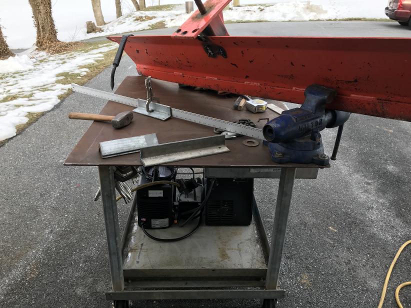

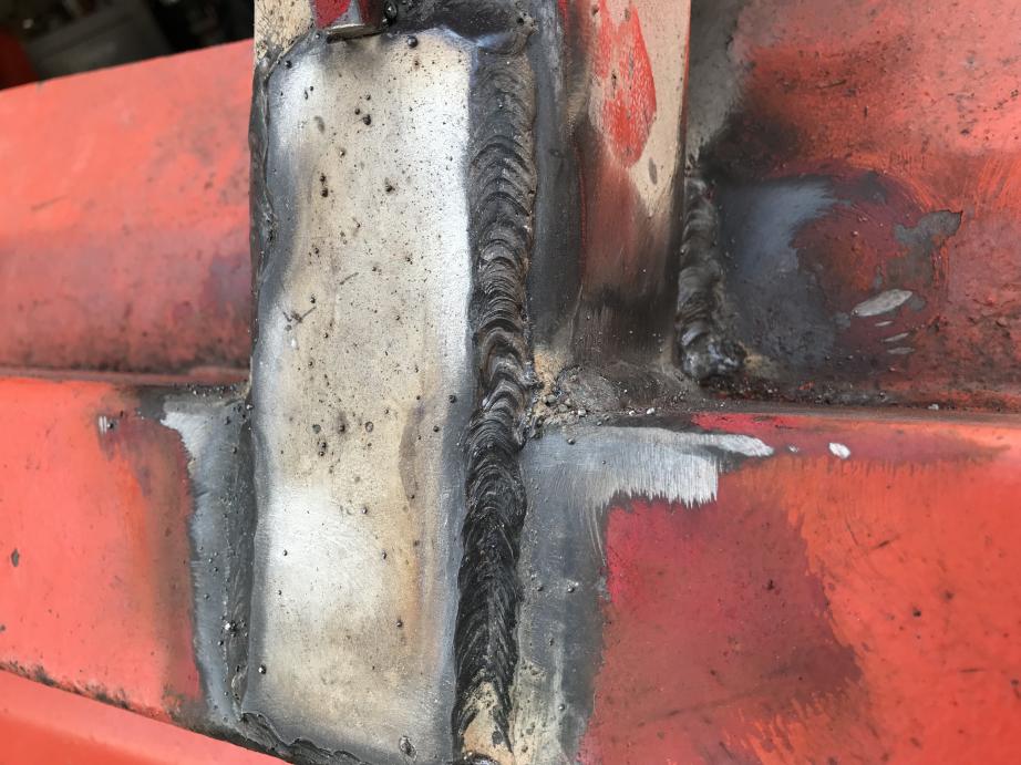

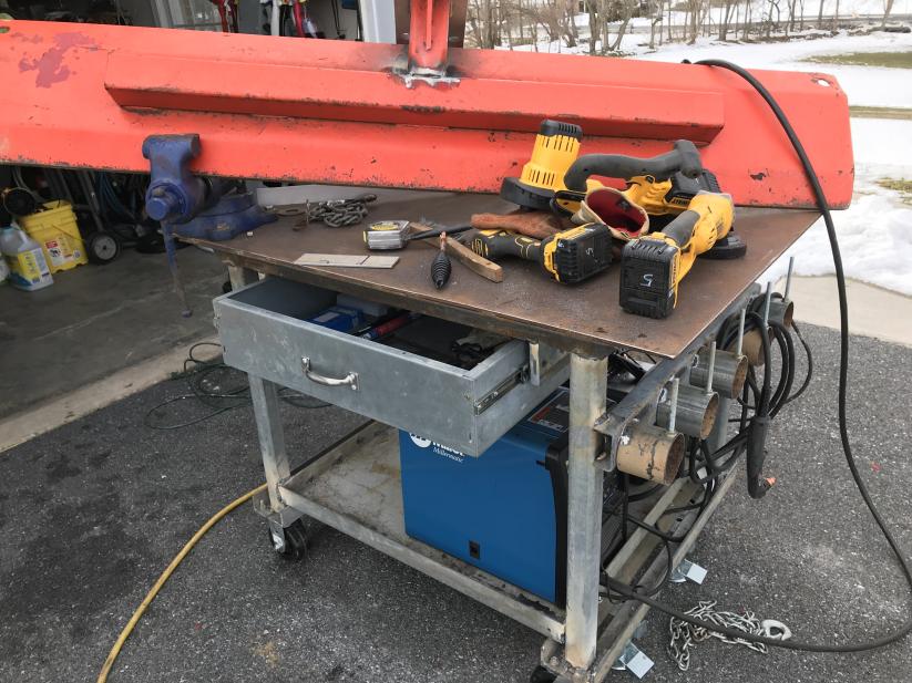

The factory welds LOOKED fine till they let loose. I didn't enjoy having breakage, but I did love being able to wheel the table out and glue it back together. I did add a piece of 1/4" plate over the T joint of the blade's frame for some reinforcement.
The short piece of angle with the straightedge clamped to it in the second picture was clamped to the flat top plate to tack things up. That allowed measurements to be taken to ensure the blade would be parallel to the plate. The work was done with the blade clamped as shown, which eliminated using a level to check it.

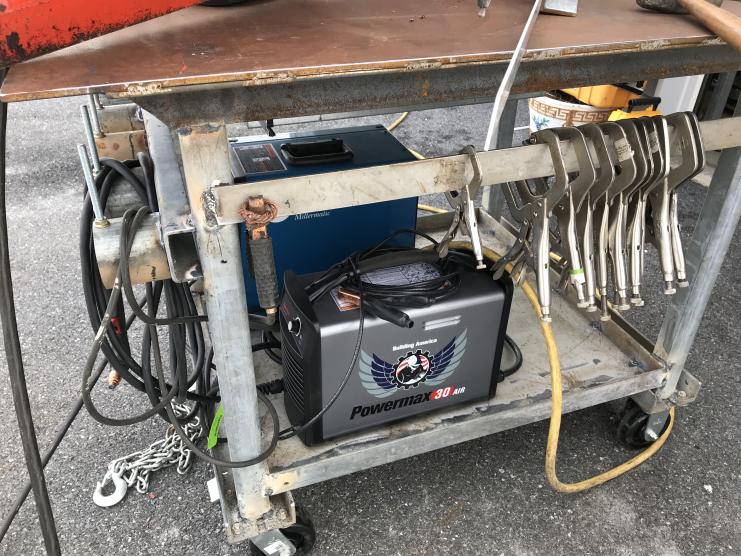

With the exception of the wheels and floor locks, the table is made from odds and ends pieces from the scrap pile at work.
