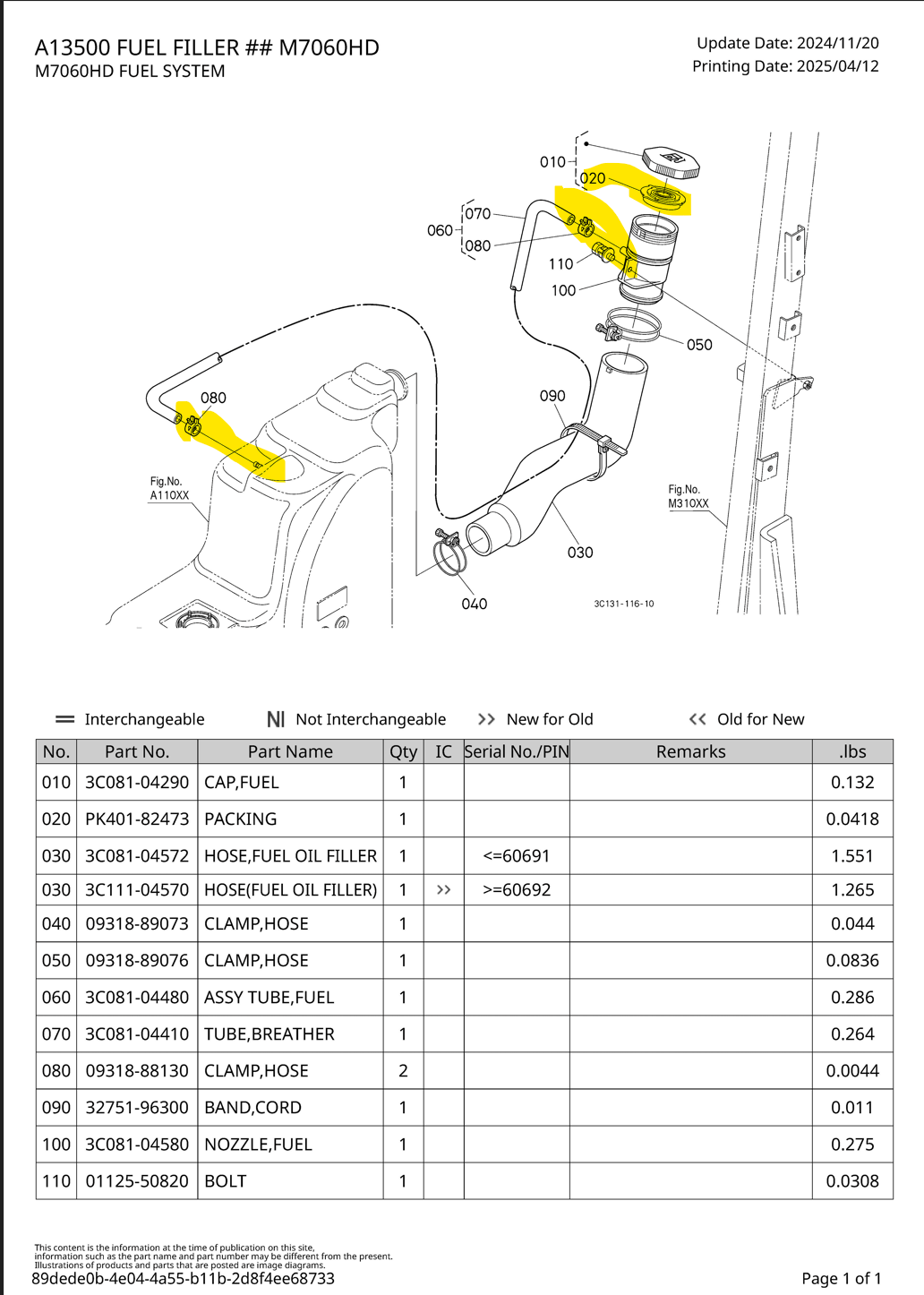

Ok, I have the tank drained.
A bit of good news, I think anyway.
I had the fuel cap on tight and the water separator fuel feed line in the closed position. The fuel stopped draining and I knew it was not empty. So I took the fuel cap off and it started draining again. So, for sure the vent is clogged and that would explain the tractor losing power after about 30-45 minutes of use. I have that question in another post.
On the fuel tank, once I drop it, how best to clean it out as I am 99% sure I was getting biofilm built up due to the water accumulation in the tank.
The fuel vent line that connects to the neck of the fuel tank and goes to the top of the fuel tank is clear. I blew air threw it no problem. But that is a closed loop to the tank.
So in the diagram below, where does the tank actually vent? I did have to replace my cap not too long back. What is part number 020(packing) just under the fuel cap, I don’t think I have that. The fuel cap itself does not appear to be vented.
See my post here.
32,533
8,159

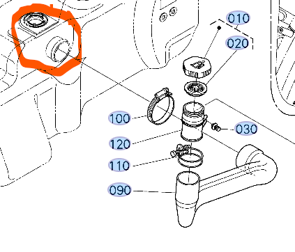

#20 is a cap seal and vent in one.
The vents are different if it's a Cab model or a ROPS model.
Which do you have?
32,533
8,159
Yes if you don't have part #20 that will 100% cause your venting issues.
I might be your water intrusion issue too, it might just be causing a strong vacuum sucking water in.
