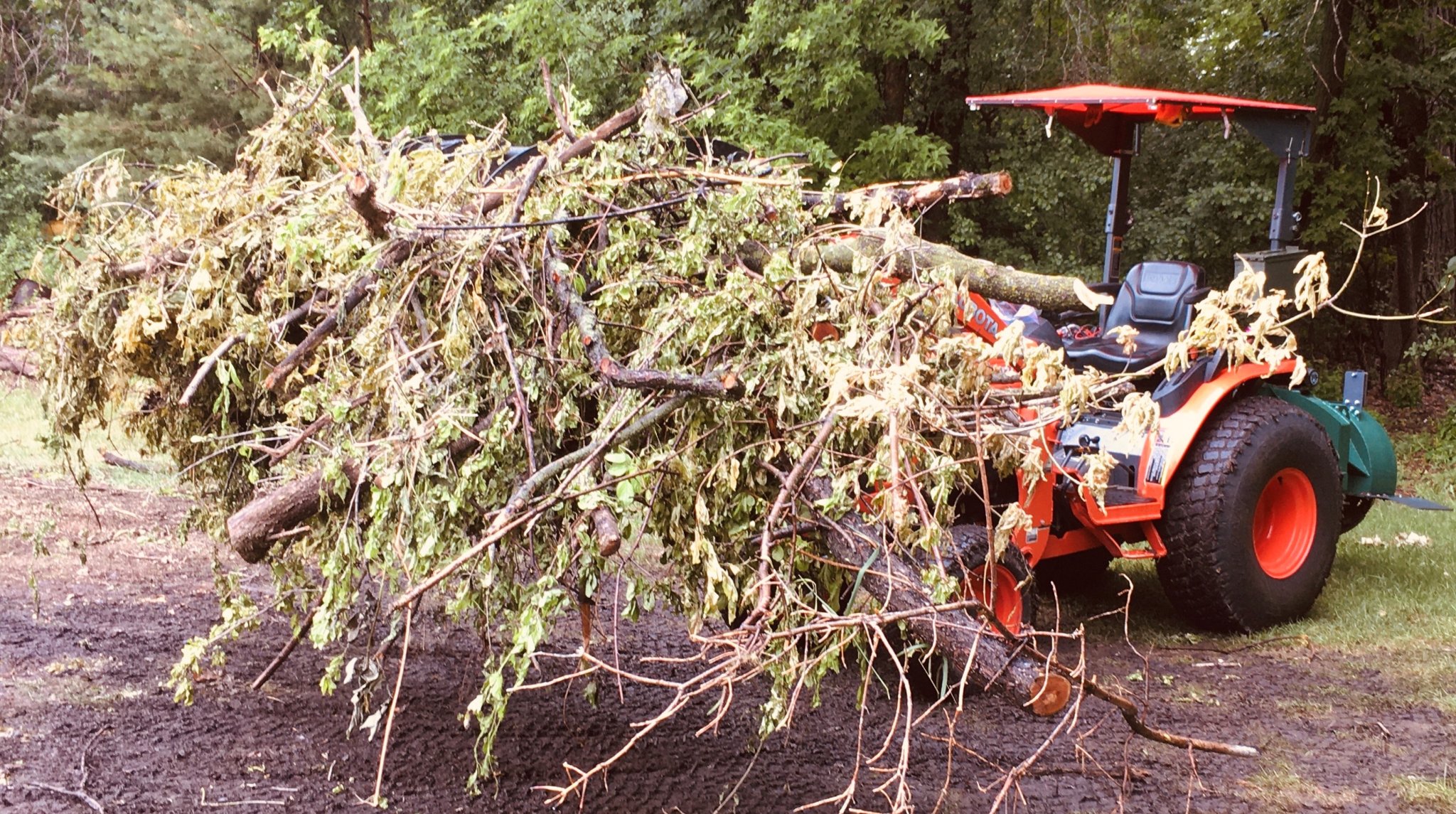

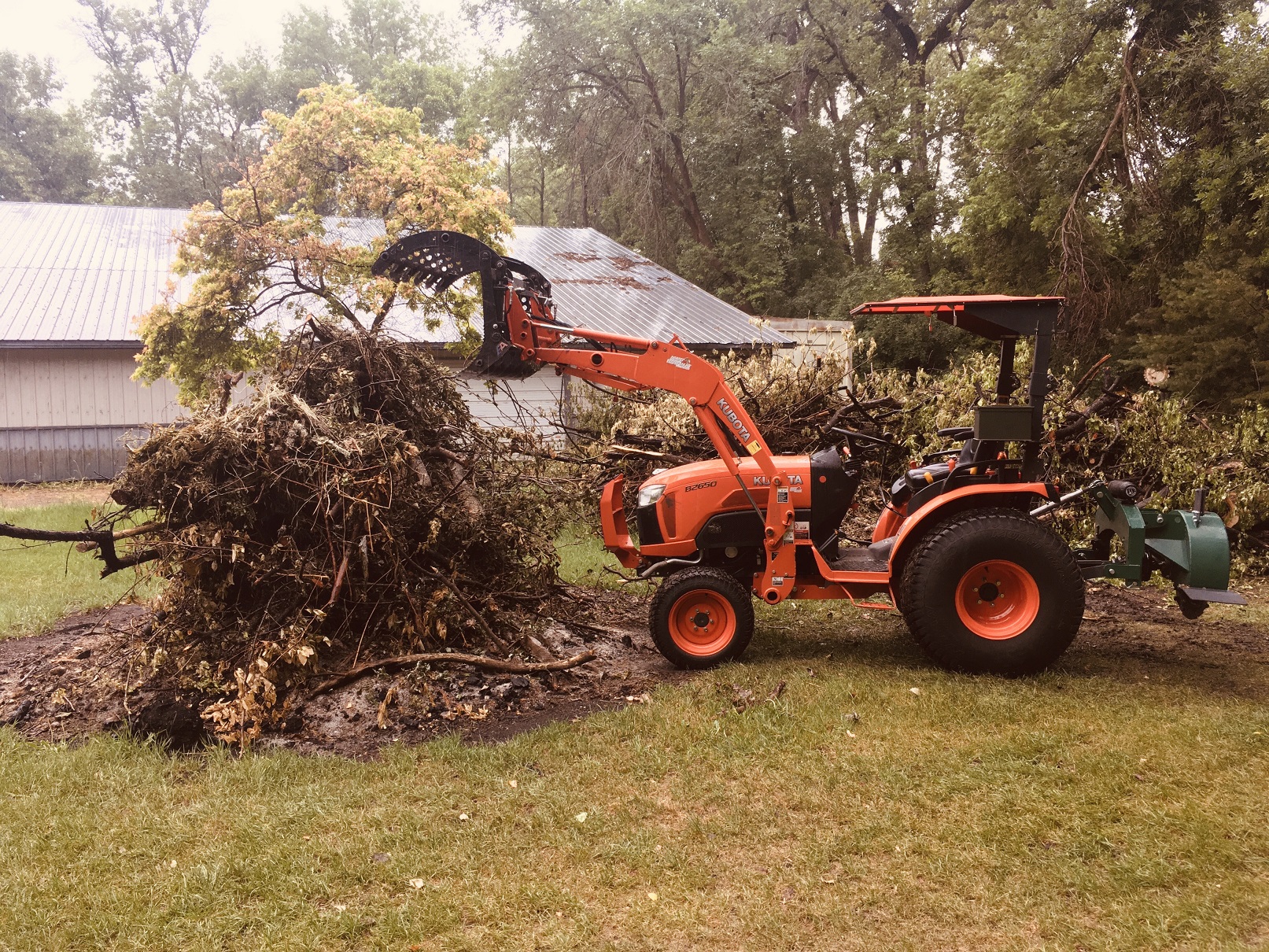

Dusty, There is no doubt that having a grapple will make easy work of clean up duties! "BG" (before grapple) our two young sons and I would cut, load, and haul the brush/trees and then unload at the burn pile. When the boys graduated and moved out, I bought my EA 55" grapple. Now "AG" (after grapple) the cleanup is a breeze and the less time it takes is unreal. There just is no comparison between how much hand labor is involved compared to using the grapple.
Here's a couple of pics of feeding the burn pile and what the grapple can grab and haul. Sometimes it would be nice to have a tractor mounted periscope to aid in maneuvering through the woods with your load!! :ROFLMAO:

Great feedback all
Your pictures attached are exactly how my truck & trailer look after hours w the chainsaw, machete, rakes etc …
Like you, my 2 teenage sons abandoned me for college & now I’m doing all the work by hand - just back breaking & brutal.
That picture is exactly what my goal is w the grapple - plus being able to move felled tree lengths that I’ve cut & need to be cut into rounds & moved to the splitter.

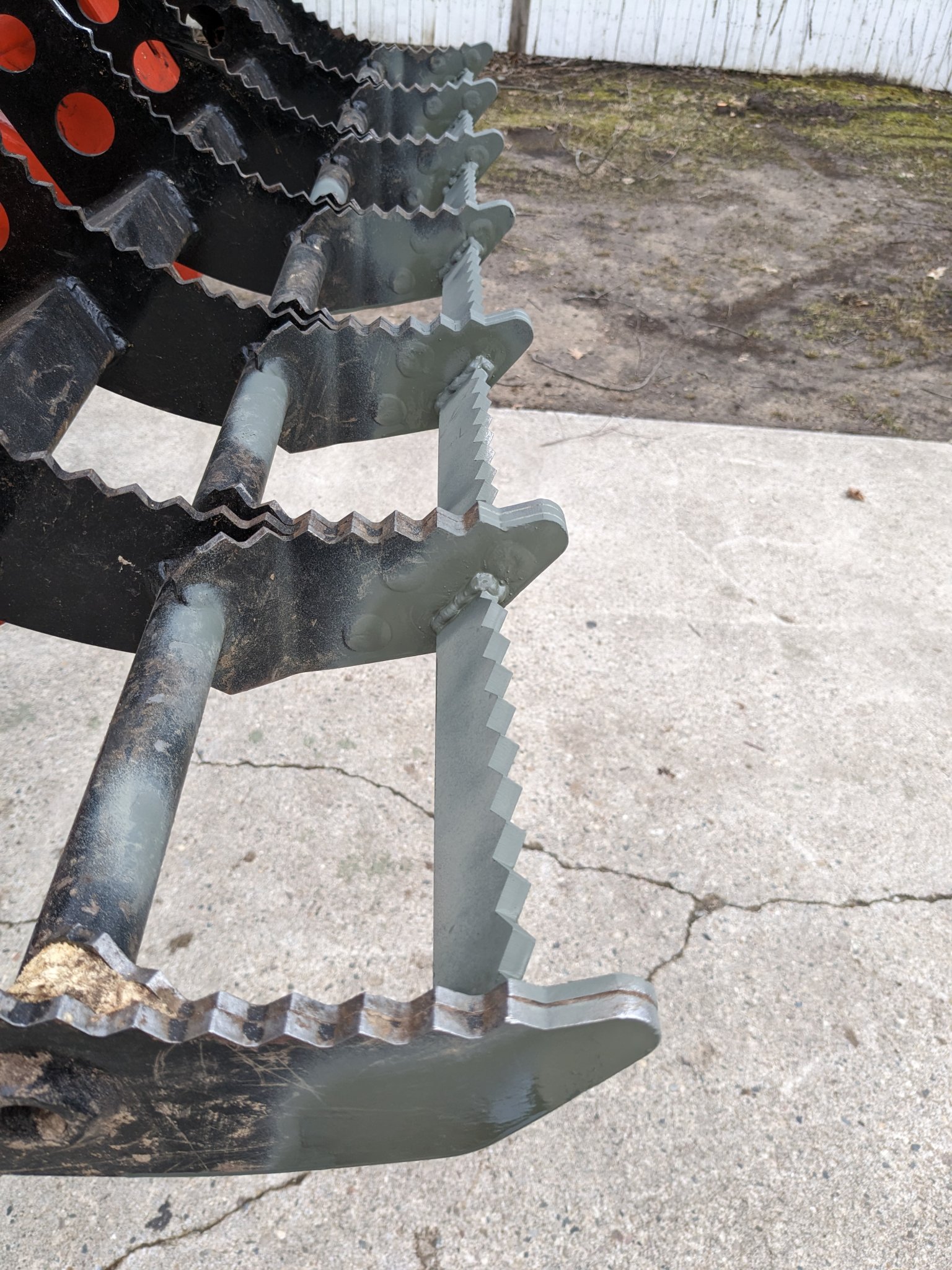

I have an EA 55" that I have an extra horizontal bar welded in near the bottom to shear off the vines and thin roots.
The long or short bottom tines more a personal preference as both will work. I like the short bottom root rake style as I find it more useful in ripping out.
The one thing that I have found to be worth the money is the serrations on the tines as it helps hold very large loads from slipping. Attached is the photo of the mod I did to my grapple it really works well for what I use it for.
