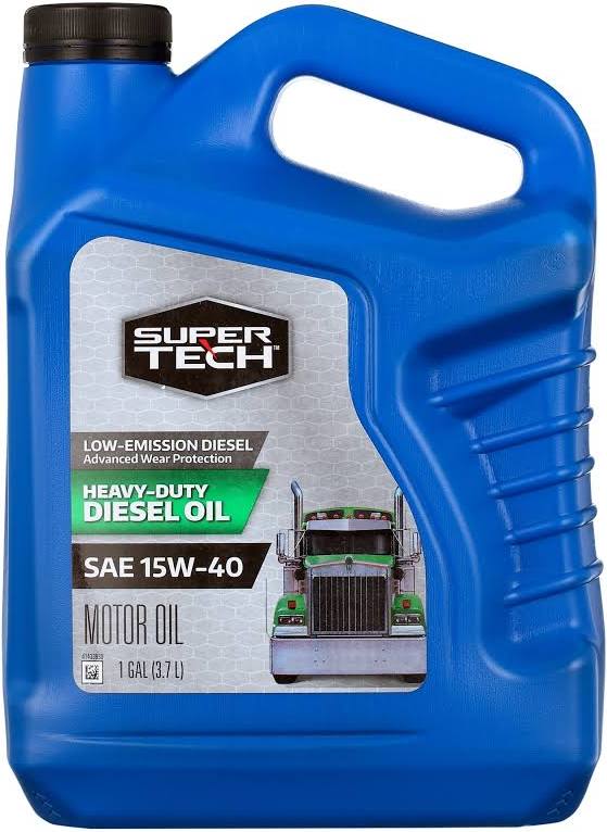

WalMart SuperTech 15W40
Everything else is SuperFluous
