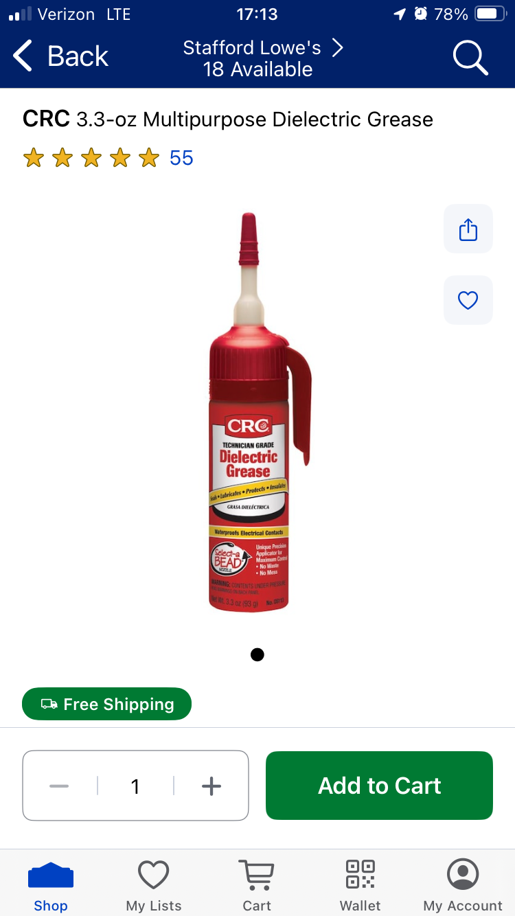

I use this...there are other products out there, but I can get this at my local big box hardware store, I’ve used several CRC products over many decades and it’ll last me at least ten years at my current consumption rate.

CRC makes some excellent products! I especially like their contact cleaner.
