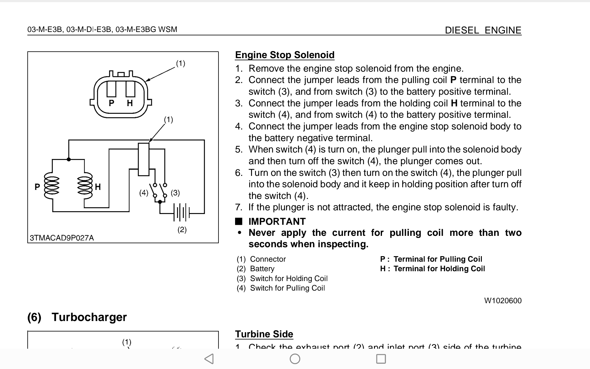

Ok, a step further. Found the engine manual.
The solenoid has two coils against the chassis, so two coil design as PoTreeBoy pointed out. I had measured between the two pins, that was my mistake.
So the pull coil has about 0.38 Ohms, the hold coil about 17 Ohms. The pull coil has it's own switch that disconnects it when pulled in.
So the coil works, but is the pull coils current too high?
Why is the fuse blowing all the time?
There must be something else connected to the fuse, I need the workshop manual of the tractor.

Reading the bold statement in your manual’s information above makes me think the pull in coil is NOT being properly released before the fuse is blown out!
No, solenoid works fine. It is pulled in in under 100ms and the current goes down to 0.8A. You cannot have high current flowing for longer because the internal switch disconnects the pull coil.

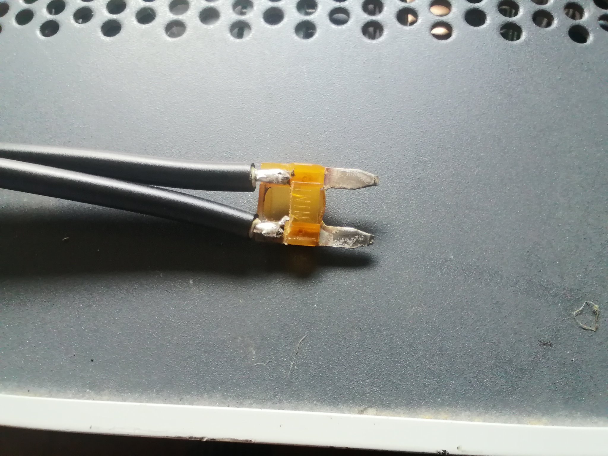

So current must flow elsewhere. I built my friend a test cable to measure the current over the fuse. He lives almost an hour away from me, so fault finding is not straightforward. He has the faulty tractor and I have the test equipment :)

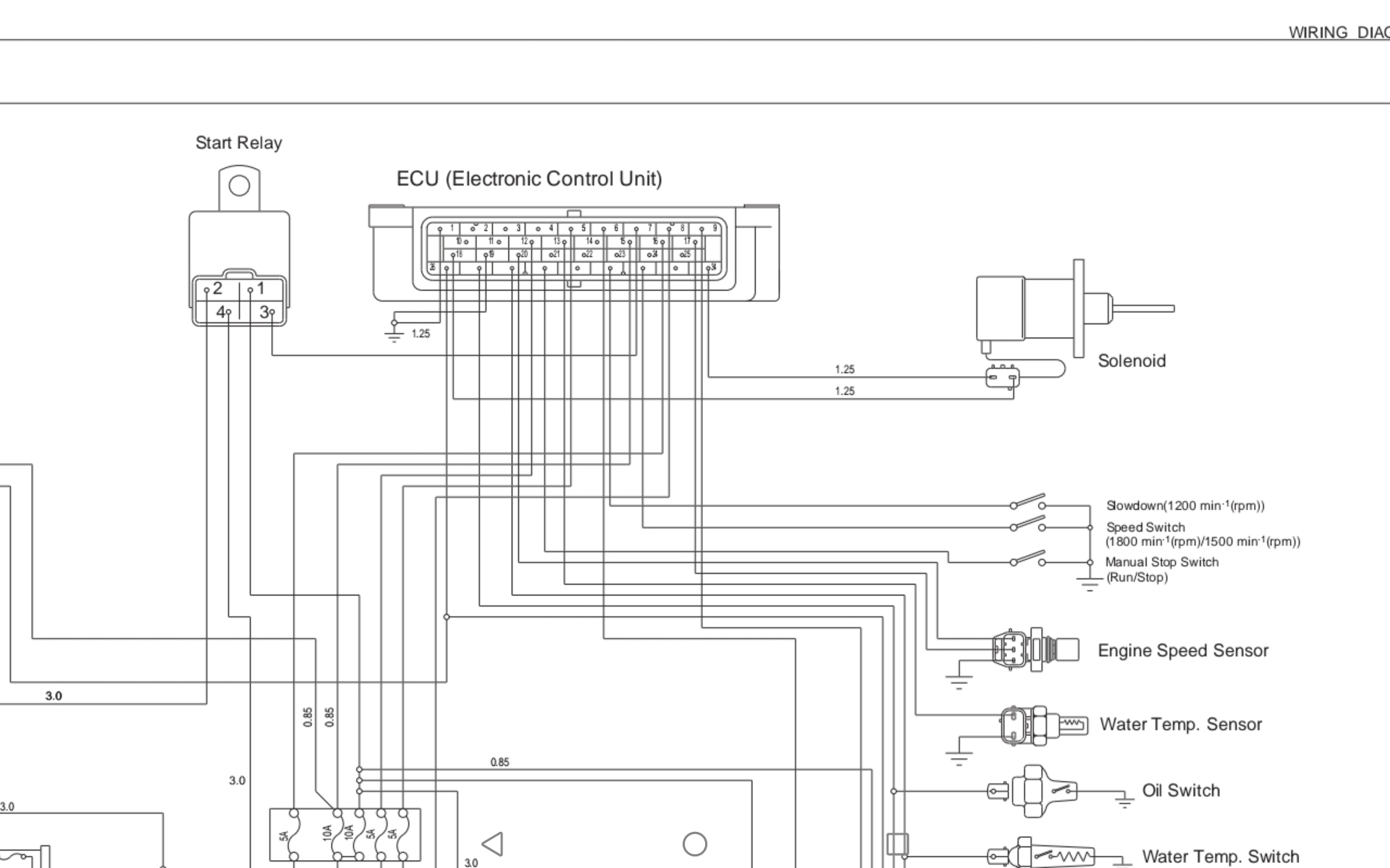

On that style coil there are normally 2 feeds one from the starter and one from the ignition.
When cranking the coil gets a signal from the starter to pull in then the signal from the ignition feeds the solenoid.
There is normally a relay that controls the pull in coil and that fuse he keeps blowing is probably the feed for the relay.
In this case both coils are driven by the ECU. Not sure why they do it this way, maybe to check the current for faults.
Keep in mind, this schematics is from engine manual, it may be different on the tractor.
He will measure the current now with the little adapter above and hopefully we will get a workshop manual and we work from there.
Then you down to bad solenoid (most likely), or a chaffed wire intermittently shorting, or a bad ECU, one can hope not that.
