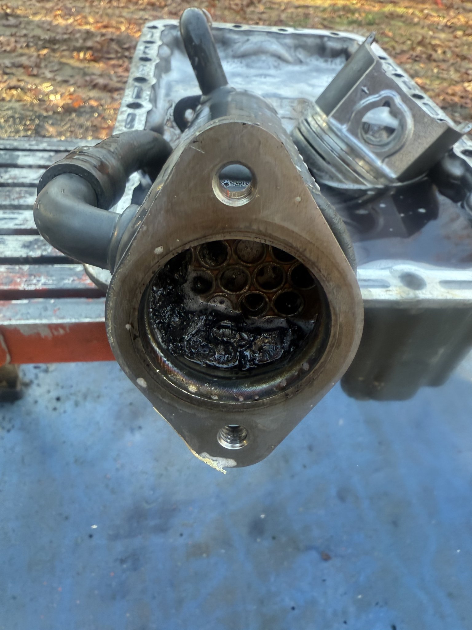

Turbo is not leaking. No oil observed on or near it . Shaft has zero play. The reason I now have it torn down is because the glow system was not working correctly . Cause - corrosion on the terminals. Glow plugs themselves work fine . I tested each with a 12 volt battery. Number one cylinder was low on compression. Found a bent connecting rod on one. I also found two cans of starting fluid in the tool box. Now we know why the rod is bent.
Back to the issue I suspect the owner, like most , don’t do the regen .
SO a whole lot more information!
Yes low compression (causing unburnt fuel in the system) will cause EGR issues!

#1 piston had a bent connecting rod caused by using starting fluid? My guess. #1 very low on compression but owner still ran it. Glow system terminals had corrosion so no continuity .
