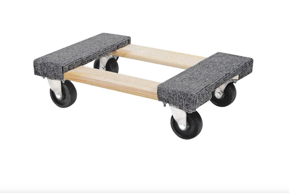

Mine sites on a harbor freight dolly….makes it a whole lot easier to massage it back on.
A year or so ago I added Pats, and that made a big difference…I still use the dolly though, makes it really easy to move out of the way.

It does. Can you post a photo of the dolly so I know what to look for?

I have lots of these of various sizes. Some I have fastened plywood to the top like the one that holds my grapple. Even my tiller sits on two small ones. Just makes it so convenient to attach or move around the shop. You cannot buy the casters for what they cost.
