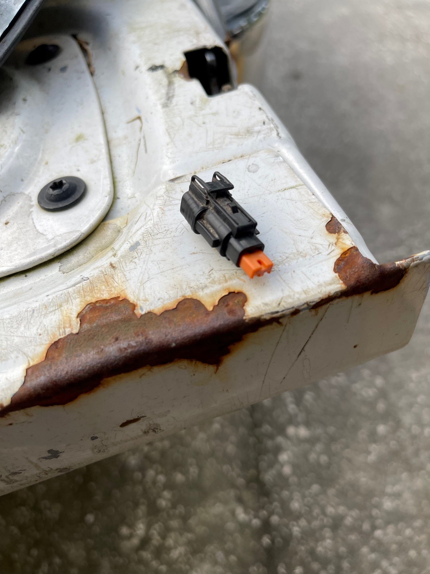

My dad has an MX 5200 and recently got the tractor hung up in some gallberry bushes. The PTO stopped working and the E95 code started flashing on the dash indicator. Looking under the tractor we found that the wire was pulled out of the plug for the (I'm assuming PTO trigger). It's a two wire plug on the side of the transmission. One wire is capped off with rubber so there's only one wire running to the plug. The terminal in said plug broke when the wire was pulled. I'm needing the terminal size or type so I can solder it back on the wire and put it back in the plug. The plug and pins sticking out of the transmission are fine. Can anyone point me in the right direction? It looks like a metri pack or weatehr pack terminal but it's smaller than the one's I've got to try to replace it. Any help is greatly appreciated.
I've attached a picture of the plug in question. The orange piece pushes in to lock the terminal in place
