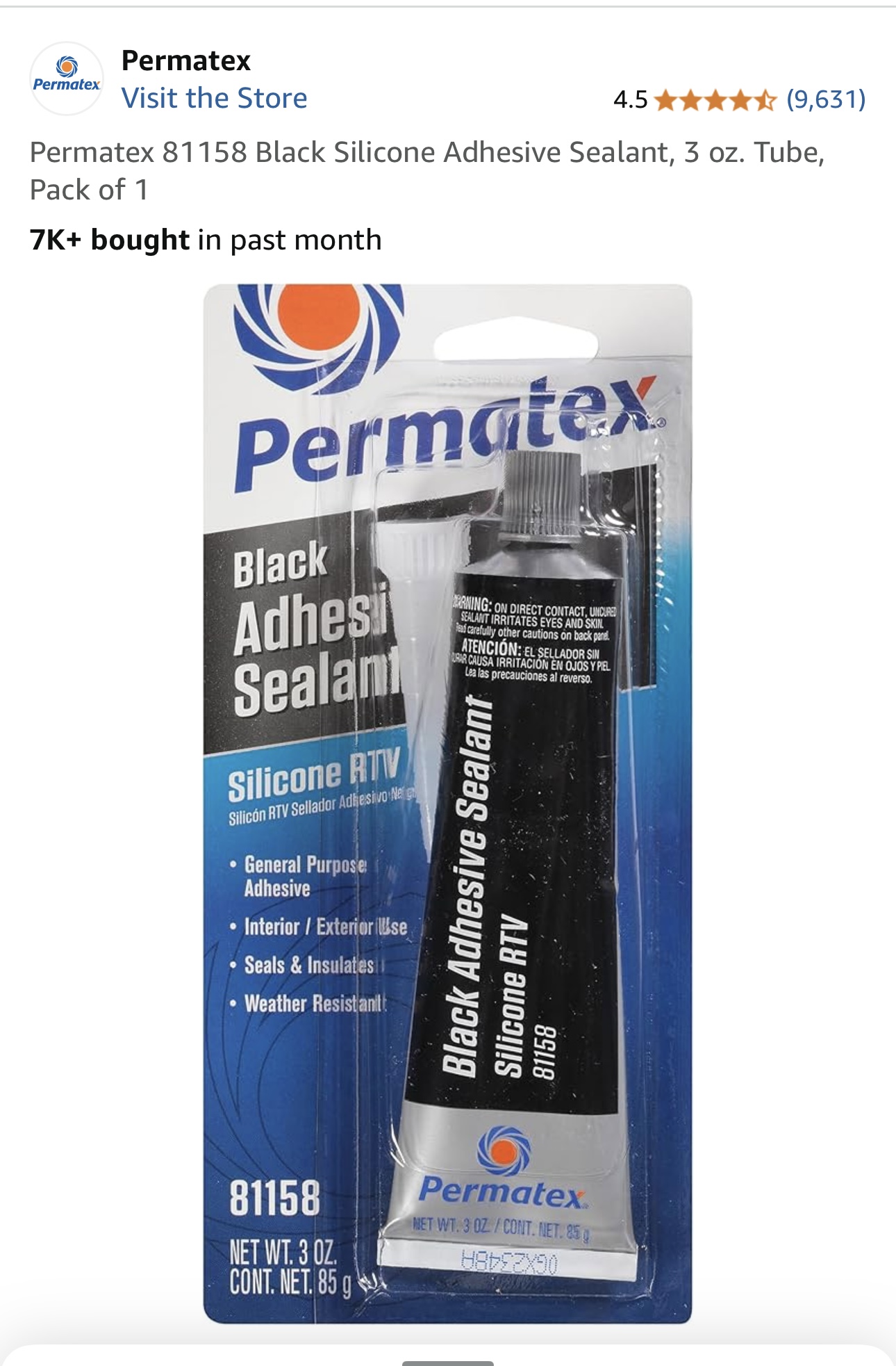

If you have any seams along the bed that could take a bead of silicone sealant, that’s time well-spent.
This is what I use:
This is what I use:
That’s good stuff. I patched a crack in the bellows gasket of our washer with that and a piece of bicycle inner tube.
Held for almost a year until we bought a new washer and dryer.
Was @D2Cat ‘s recommendation if I recall.
