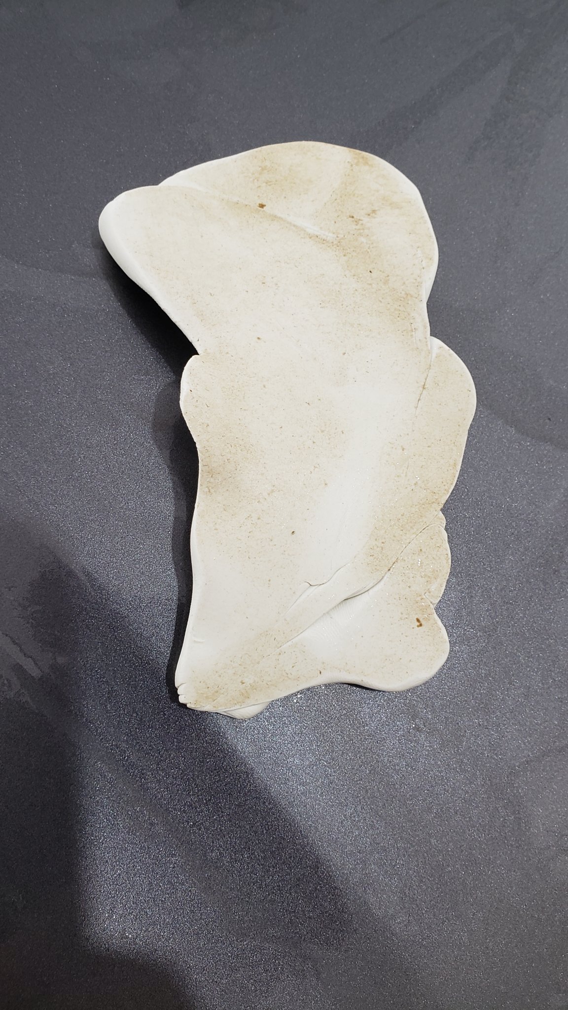

I also encourage the clay bar step. It's kind of wild what it will pick up. Here's a recent example from a section of a freshly washed 'clean' hood. Doing this before the orbital helps reduce rubbing abrasives around in the paint.

If you are going to clay the finish, you may find it is more effective and easier to use Synthetic Clay.
You will also need a suitable liquid, which can be a high quality wash and wax mix.
