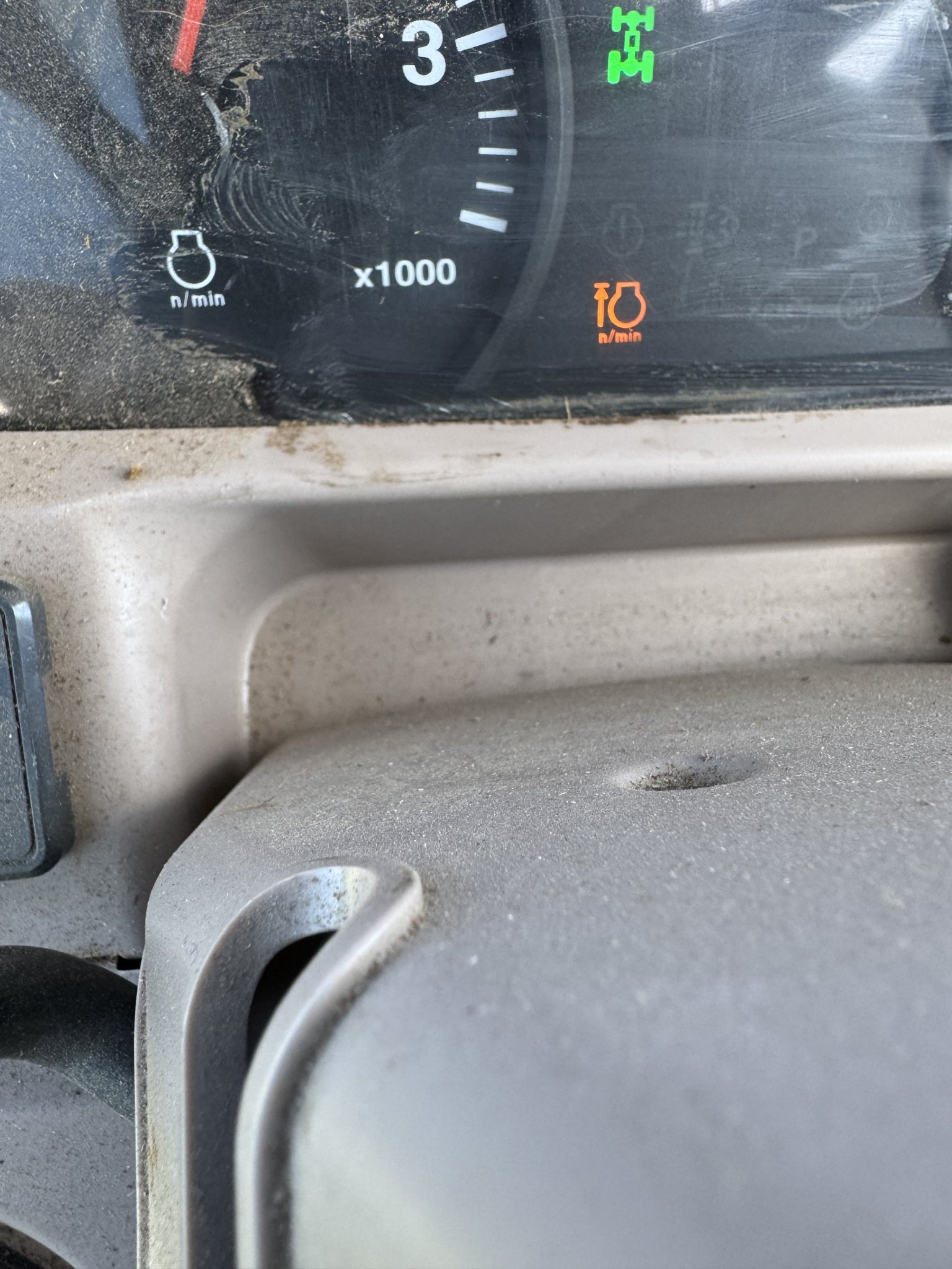

When I engage the pto on my 7060, the light that tells you to increase the rpm’s durring a regen comes on. It stays on until I turn the pto off but the tractor never goes into regen.
the light will come on and I can bring it to idle and it will still go off. No beeps or other lights are coming on.

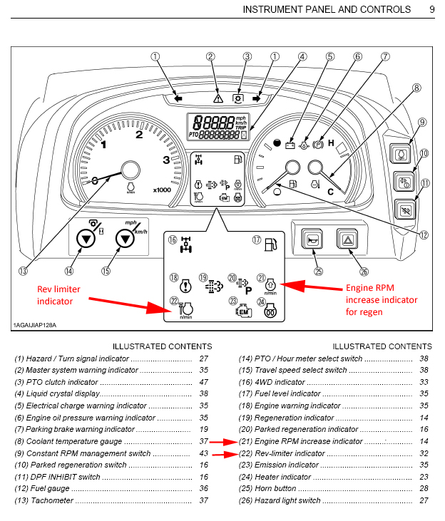

Perhaps you should read the manual and figure out what the symbols on the dash actually mean.

You must have the E-PTO lever engaged. Engine rpm will be about 1950ish to make 540PTO rpm, rather than 2200.
This is the only time the rev-limiter light comes on in my tractor since I don't have the 6-speed transmission but I do have the 540/540E PTO.
