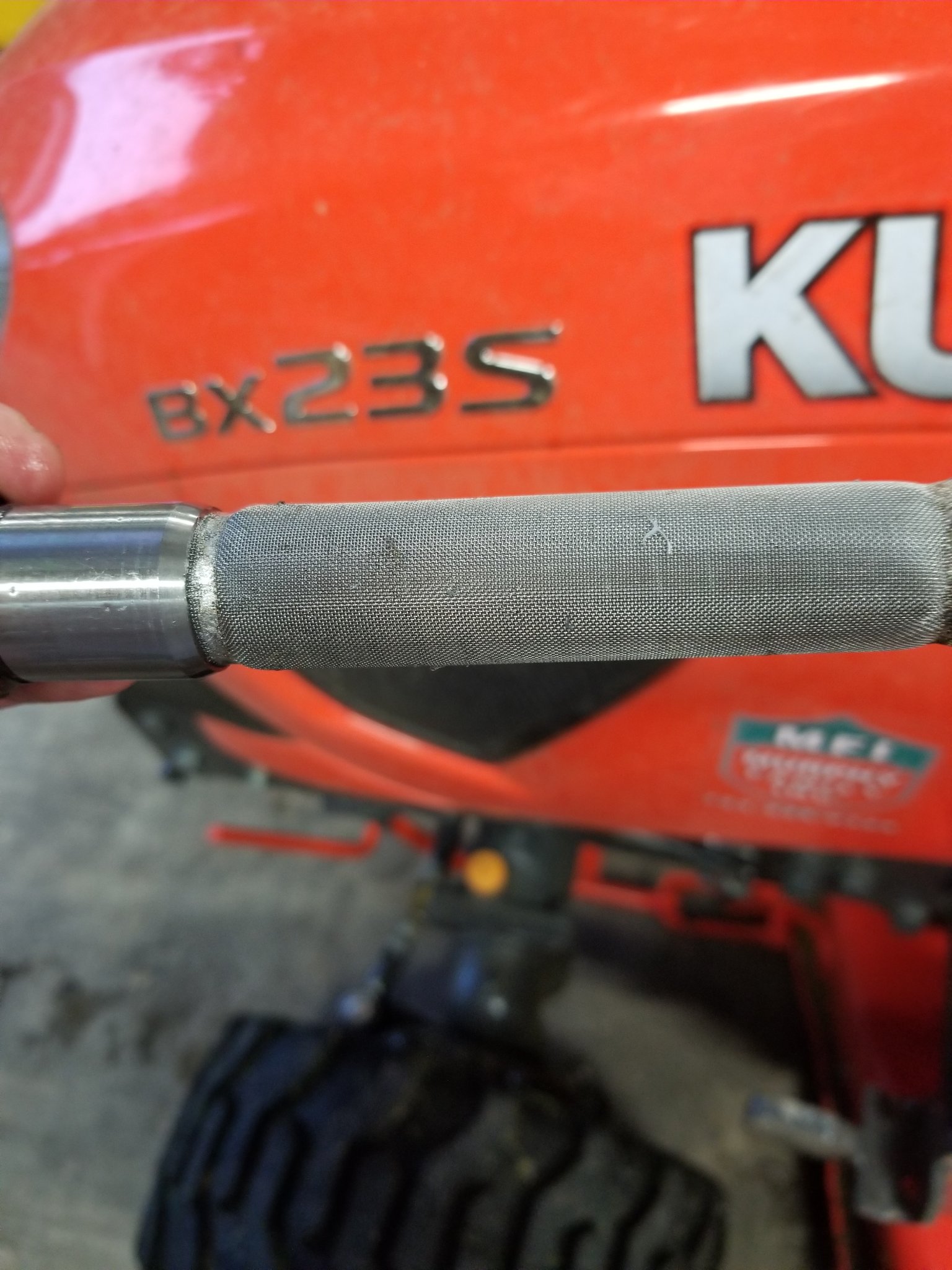

There is some discrepancy in the owner's manuals as far as changing the hydraulic fluid. Some older ones said to do it at 50, some newer ones said 400. I changed it all at 50. My screen was quite gunked up with RTV particles.

I also changed mine at 50 hours. I was expecting the screen to have some 'gunk' in it, but it was remarkably clean. Changed the filter (only) at 200. We'll soon see what the screen looks like at 400...
