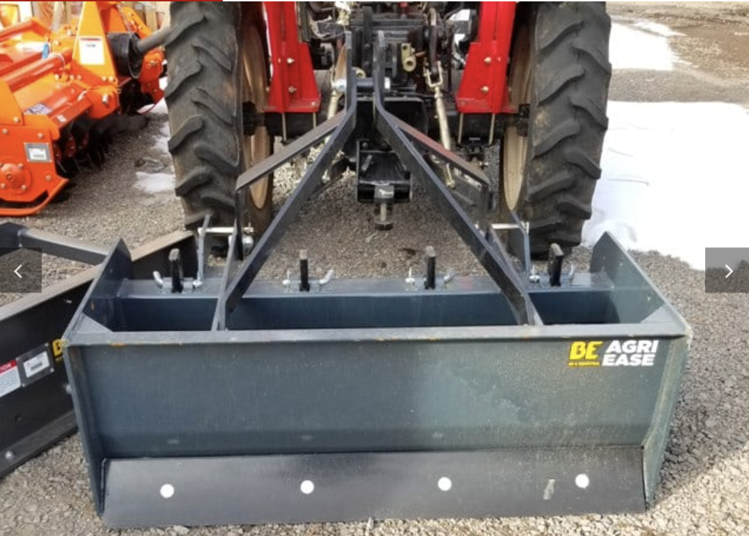

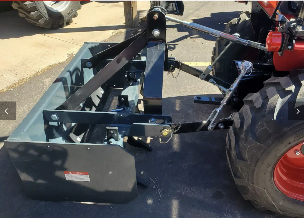

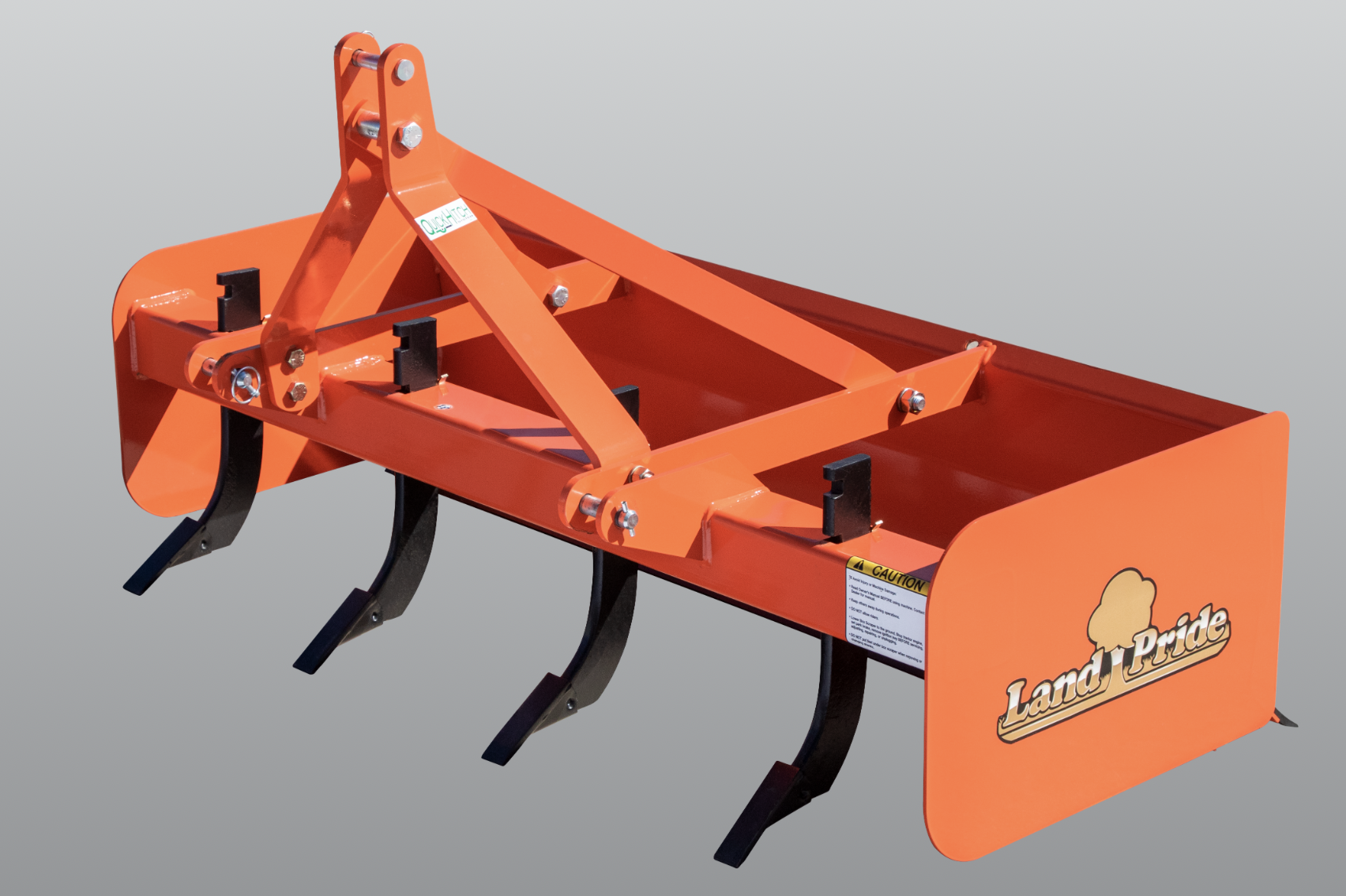

I live in a rural area, so not a lot of options, especially in the 48" size. Plenty of used for sale, but they're all 5" or larger. There's another dealer in town that has a Braber Agri Ease 48" box blade in stock. Less expensive than the Land Pride and the one nice feature I noticed are the adjusters for the shank depth are actual pins instead of the metal compression-style springs on the Land Pride. That feature seems easier to adjust and more convenient. The Braber is about 50lbs heavier than the Land Pride and described as "heavy duty" and rated for tractors up to 50hp, while the Land Pride is considered medium duty and rated for a tractor up to 25hp. All other features aside, should I just get the Braber and be done with waiting for the dealer that keeps kicking the can along telling me they'll be here next week?
Land Pride BB1248:

If the welds and thickness are ok, It looks fine to me...
I wouldn't care for the clips that are used on the landpride unit either. Mine has pins like the BE unit in your pic.

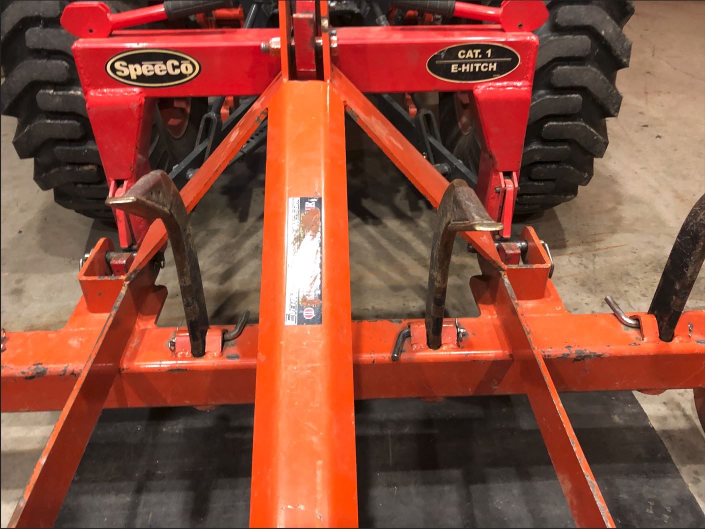

check these out...no bushings needed...
can likely find it elsewhere for a bit cheaper. It's worked great for me.
