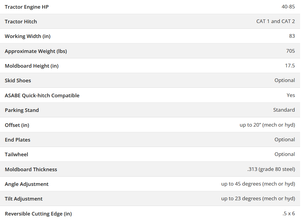

Bush Hog is another option. Does offset, angle and up to 30 degree tilt

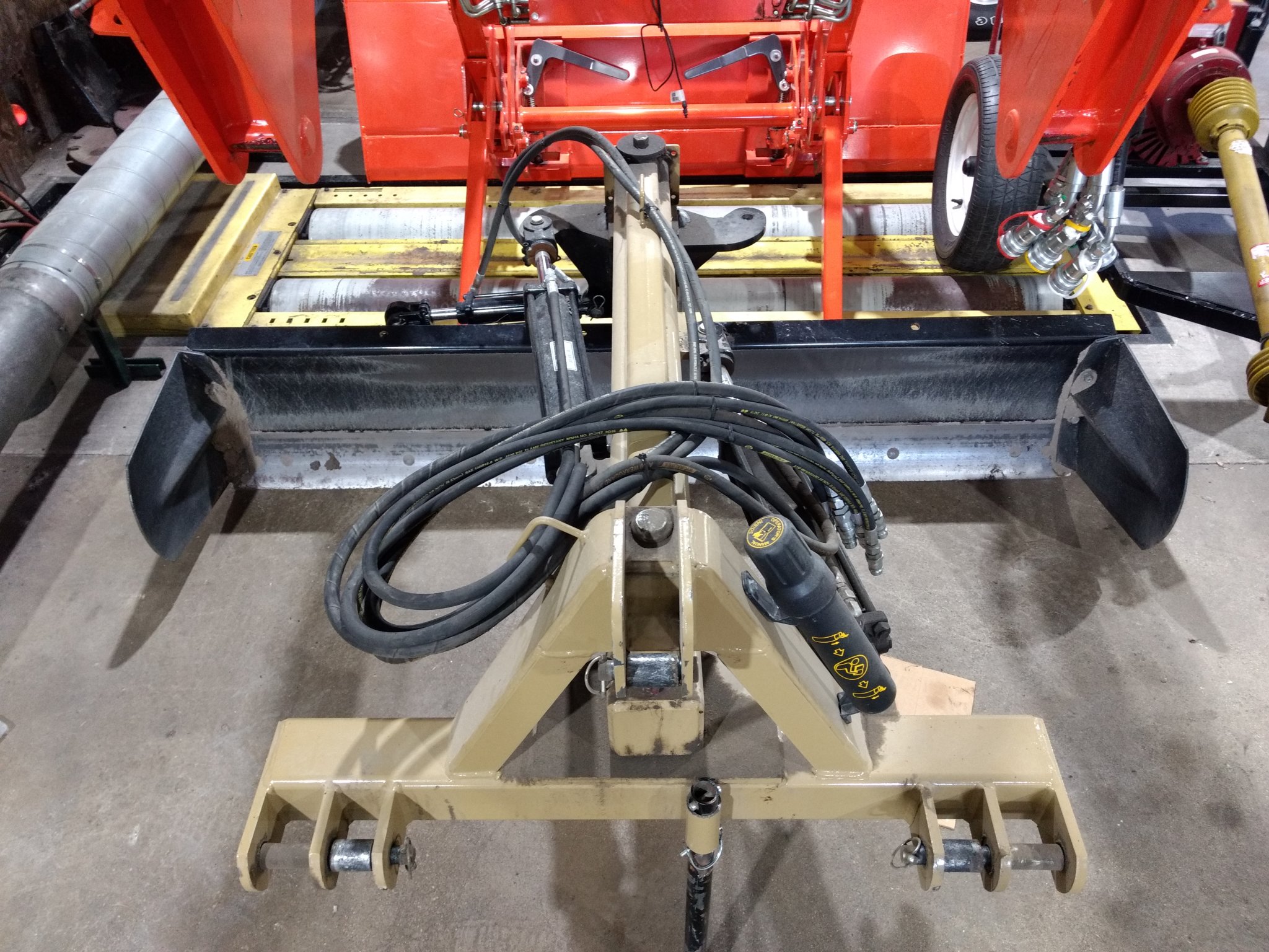

How many do you want? Contact your friendly Land Pride dealer and order one. This one is an RBT3584.
"Your friendly Land Pride dealer"....will charge BIG BUCKS for that all hydraulic blade.
The blade posted by "airbiscuit"( post #14) is a much more wallet friendly solution (not hydraulic) to accomplish the same results.
