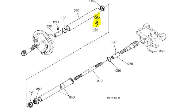

The outer tube telescopes together. Need to drive a spring pin out at the back, then take out another spring pin thru the coupling. Slide coupling forward so it disengages the splines - shaft can slide toward the back. Sorry the attached pdf is low-resolution (site doesn't accept a better one)

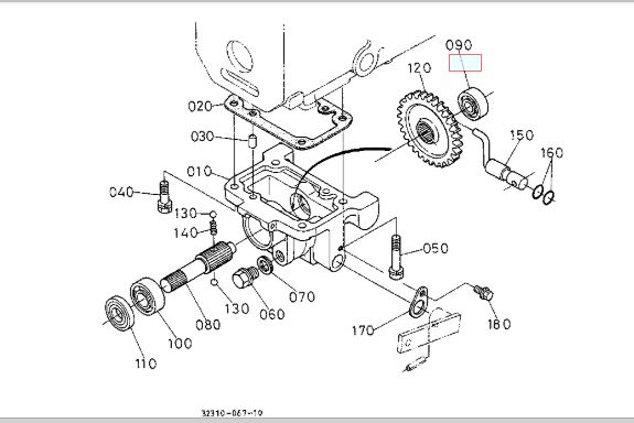

Great, thank you for the reply. Is all of the gearing that could be causing my grinding noises below the main transmission or will the tractor have to be split to address the four-wheel-drive issue? I assume there is gearing from the main transmission down to the ring and pinion for the four-wheel drive that is potentially damage?

I bet the two are related, probably pushed something to to the drive gear for the 4wd and locked it up.

Taking out the propeller shaft should allow the front wheels to rotate -
Do the rear wheels turn ok in both high and low ranges (even though the fronts just drag?) If so it sounds like there's something out of place blocking the fwd gears.
The loose shifter issue and this blockage might be related.
In the M section of the WSM the HI-LO range shift section and the Front Wheel Drive section show how everything fits tightly in there. The PTO shaft and gears run through the fwd idler gears - two pairs run together all the time but only one set is powered, depending on HI-LO setting.
If lucky, whatever is blocking the fwd gears might be gotten out by draining the oil and taking off the bottom gear box.

If the front still has issues with the shifter is now working correctly, and if when it went out it didn't damage any of the internal forks or gears then you'll have to do a tear down.
You can start by removing the drive case 4 bolts and see what's in there, if the gear is damaged, then you'll have to get inside the upper case to see what's happened.
You will need to drain the hydraulic fluid completely before you can open it up.

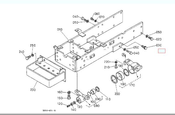

I will post a picture later but the drive shaft is being a very big pain to get out. The cover tube was stuck so I removed the 4 bolts in what I am calling the carrier bracket directly behind the front differential, this may have been a mistake as I cannot get the four bolts to line back up now no matter what I do. By removing the four bolts I was able to get the cover to slip back but now the roll pin in the front coupler is seized in its hole. I am now afraid to try and move the tractor with the four bolts out? This carrier bracket is not listed in my Illustrated parts list to understand what the function is. I need to rotate the front drive shaft to get a better angle on the roll pin but rotating the wheels does not do this. I will post a picture later but could not get it to do it from my phone right now.

What you have done was removed the front axle support. :eek:
You now need to jack up the front of the tractor to get the weight off of the front axle, and since you've gone this far pull the 2 front housing bolts and this will let you move the whole axle down and forward enough to just remove the propeller shaft coupling and the propeller shaft.
There is one bolt into the oil pan and a roll pin in the rear.
Now to put it back together, you need to loosen the nut on the front adjustment bolt and loosen the bolt so the front housing doesn't have a preload on it.
Put the axle and the housings back in place first snugging the bolts then when they are all in and snug tighten them all down, then reset the preload on the front housing per the WSM.
