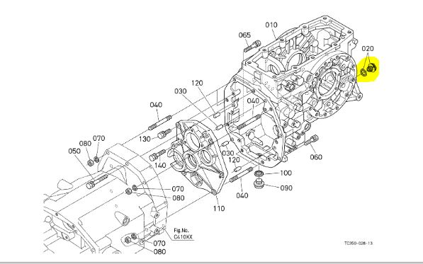

The MX5200 uses a sight glass, it is on the rear of the tractor just left of the PTO shaft.
