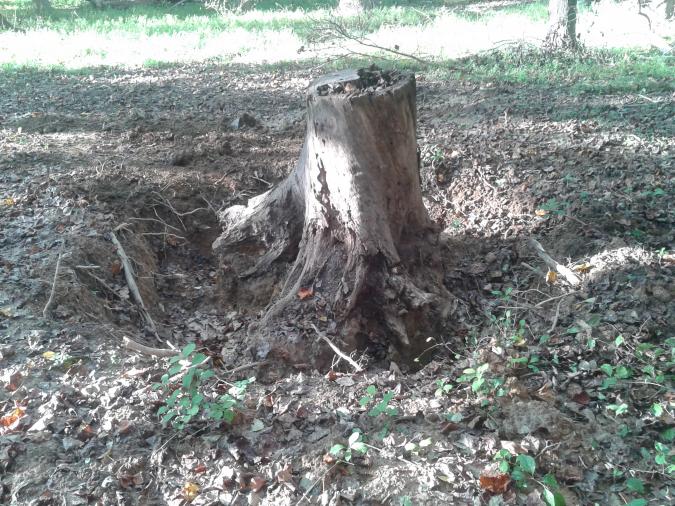

Here is a rather large stump I got out of the ground....and it did take me about 10 hours, but really I could have done it in about three had I known what and how to do it !:D

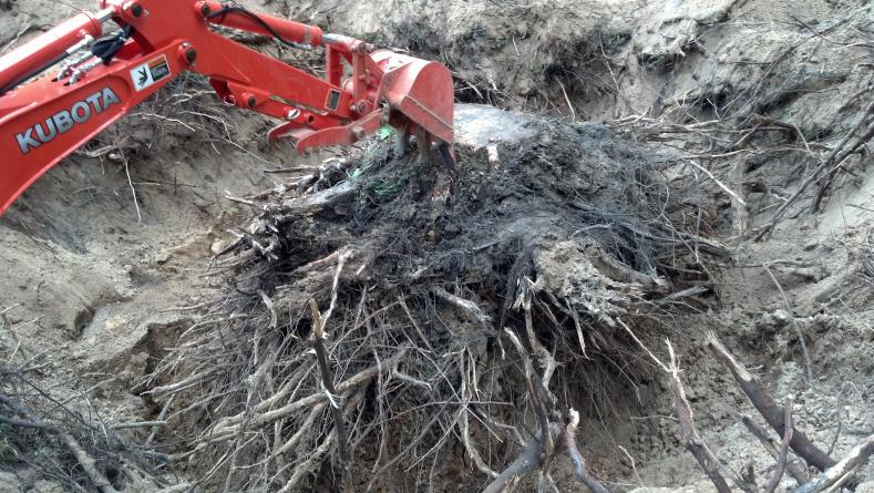

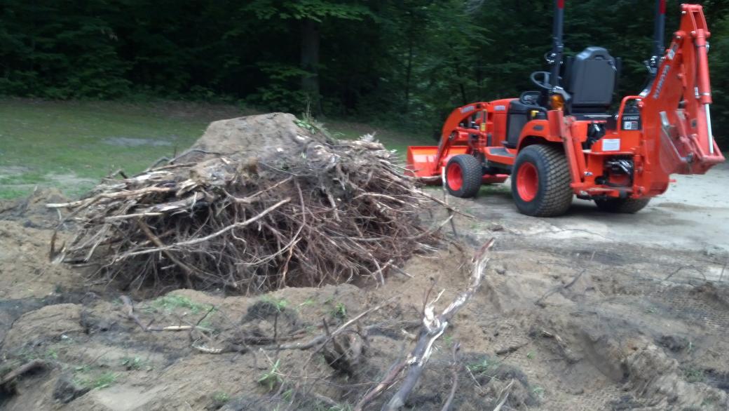

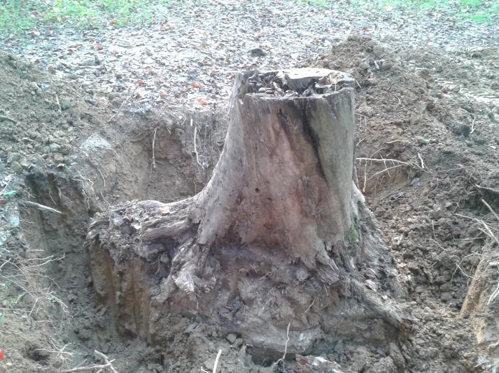

Here is a couple of pics of the stump i dug out last weekend . The next two are about the same size , but are only about three feet apart from each other . I'm sure they are not coming out easy .
