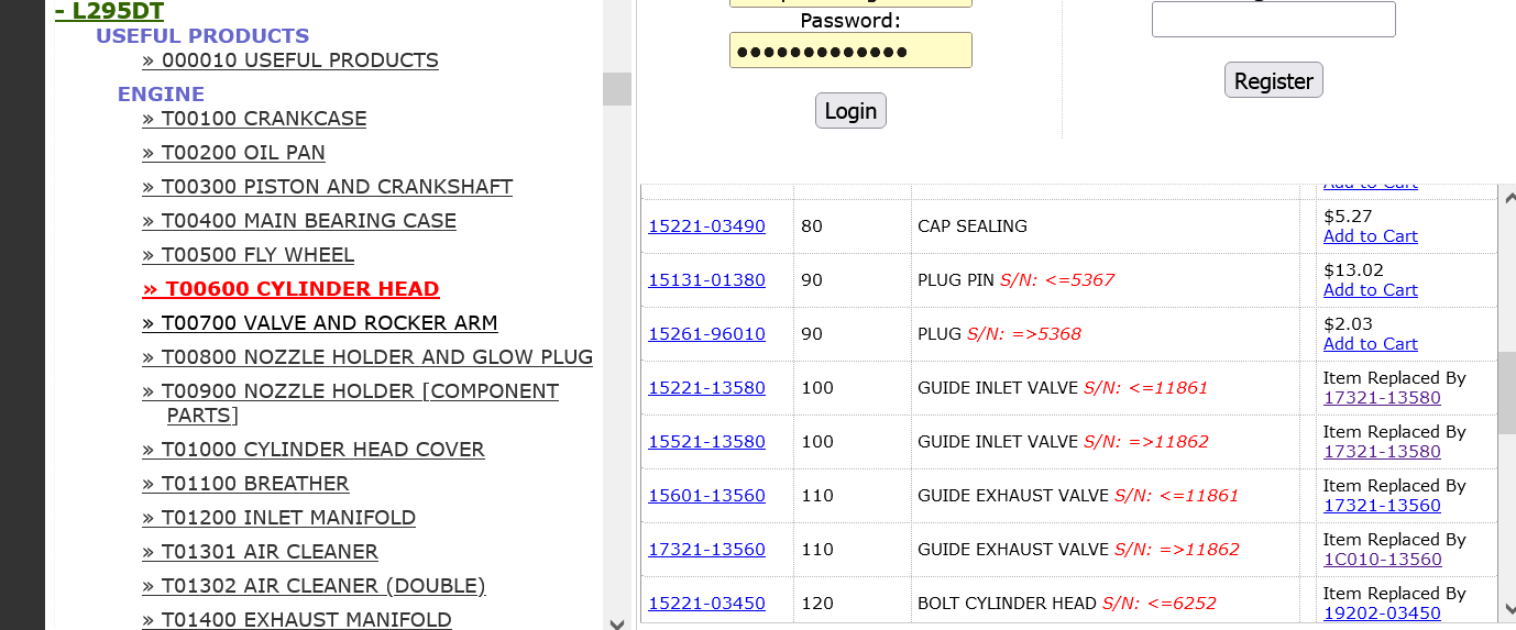

I went to this website https://parts.mbtractor.com/
and did a search on the L295DT. This website has been excellent for me for parts.
It appears that the intake and exhaust guides started out with different numbers but the superceded numbers are the same. Notice however that the last guide for the exhaust has a different superceded number based on serial number.
Notice also the indications of serial numbers by the parts. You will have to use that as your reference too.

It appears that the exhaust guides at one time were different by serial number……but were superseded …. and then the superceded PN was superceded to one common exhaust guide unrestricted as to serial number. However the intakes and exhausts have different PNs…. So it appears the intake and exhaust guides are different from each other.
While I’m unfamiliar with this particular engine…. I‘ve seen others that the guides have identical measurements …are dimensionally identical… but they are made of different alloys, with the exhaust designed for higher heat.
