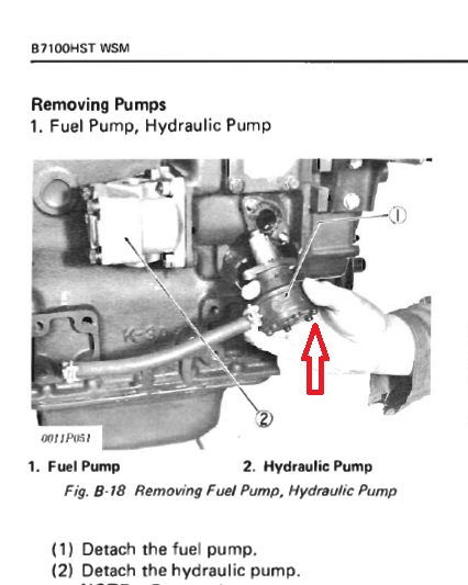

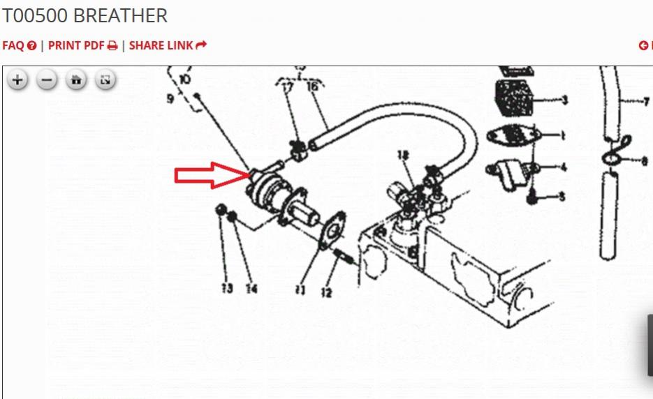

I think there is a fuel pump near the injection pump
Checking it for a bad diaphragm might be wise.
After than, a bad shaft seal on injection pump.
There are B7100 experts who will have more to say
Pump from Messicks 15263-52030 $127.43
I think you can just buy the diaphragm but need to talk to Messicks to be certain you get the right part as there are versions of the B7100

If it has a mechanical lift pump for the fuel, then that’s where I would start. When they leak it dumps straight into the crankcase. Second place would be like Dave said, the injection pump shaft seal.
