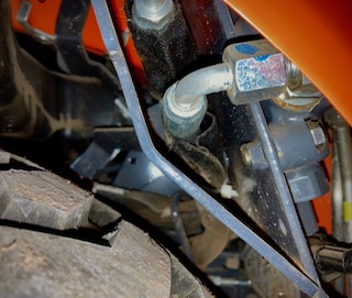

As noted here and other threads a bit concerned with the minimal clearance for the right side tire. There is about 1" between a bar that protects the control system for the FEL and other functions. Left side has a minimum of 2" between tire and fender. Image attached. Enough room for square link ladder chains?

The problem I found with the R4 tires is the tendency for the links to slip between the lugs. On my BX I made a set of ladder chains out of old car chains, not pretty but functional for the little guy, and did a modified H pattern, meaning I used what I had laying around, in an attempt to keep the links on top of the lugs. And yes Sir on the BX you really have to watch the one side so you dont rip things out,, bad juju

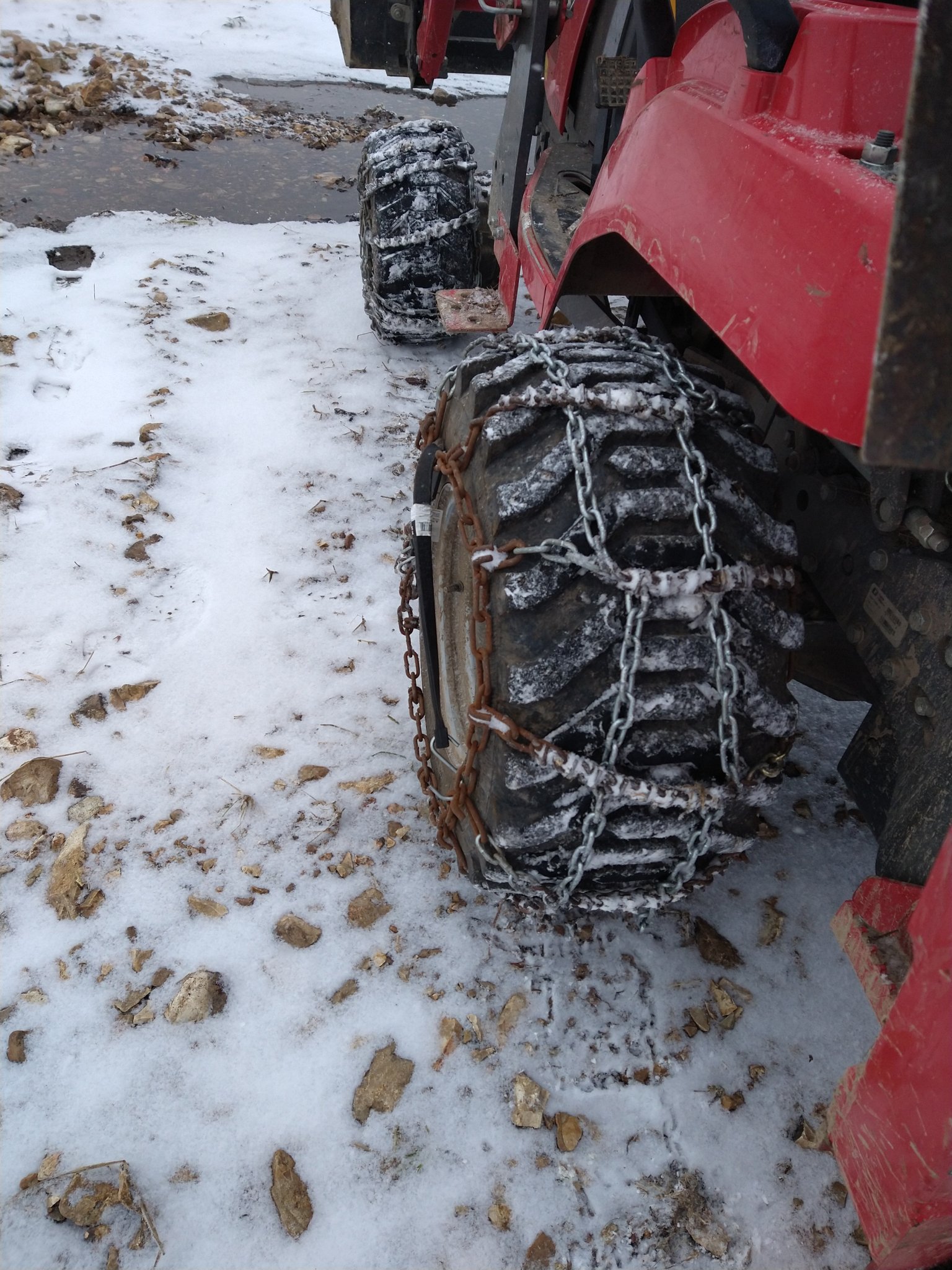

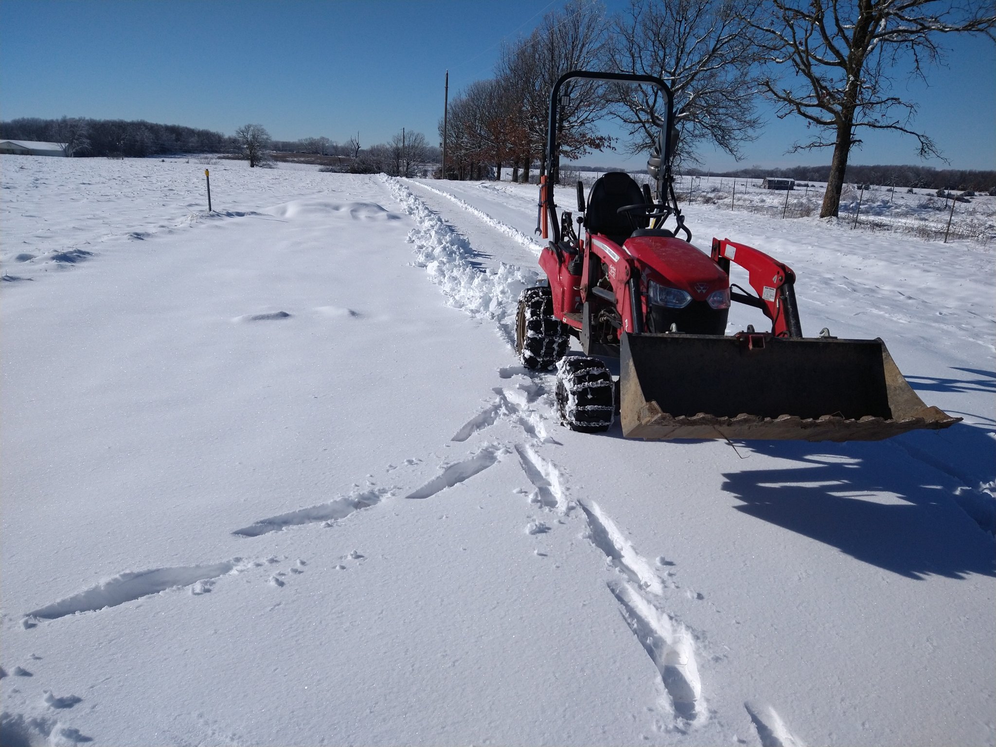

Not a BX, but a SCUT, I too made mine own out of what I had, started with busted semi-truck chains ... With my "snoopervisor"!
I'm running 3" spacers on the back, 1.3" spacers on the front ...
Works good!
The regular ladder chains do tend to fall down between the lugs though ...
