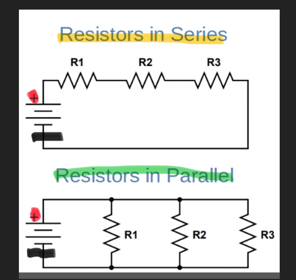

One other thing to point out on the wiring diagram is that the glow plugs are in parallel not in series as the diagram shows. They all get grounded at the plug case where it screws into the block.

Looking at the glow plugs they are all connected to each other by jumpers, so that looks very much to me like they are in series. Maybe they did it differently for the two cylinder?
The tops are connected to positive power (red highlights) by the jumpers but the bottoms are connected to ground through the block (black highlights)
See the diagrams below and convince yourself they are in parallel (green diagram), not series (yellow diagram)! Ask more questions if you can’t see them in parallel.
Oh yeah. Duh. I wasn't thinking about the ground and was just focusing on the positive wiring. Too many years dealing with A/V signal flow instead of vehicle electrics have rotted my brain.
