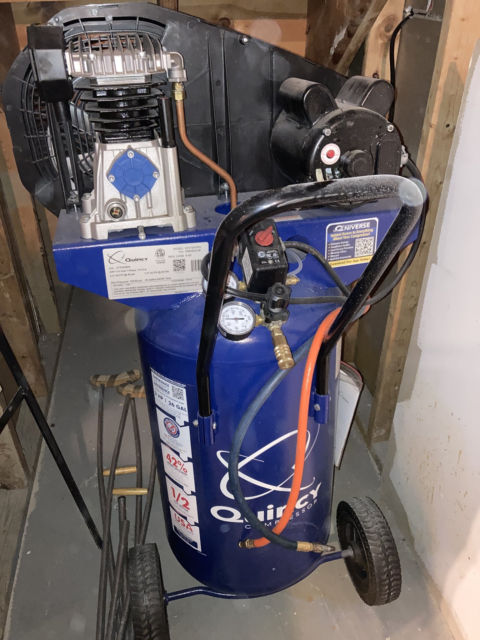

I like my little Quincy. I’ve had it for about 5 years’ish.
I give it a pretty good workout as a “weekend warrior” mechanic.
Quincy has a reputation for quality in their larger compressers, so I HOPE that “trickles down” to the little brothers as well,
It’s an “oil type”, small and “semi-portable” and runs on 110, which is convienient.
It replaced my 25 year old Craftsman, that was retired to “up north” cottage duty.
