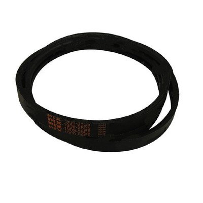

I bought an aftermarket belt for my RC-54 deck off eBay. This one:
After 3 seasons of use, I'm still extremely happy with it. It's gone up in price about 20% since then, however.
Funny, when I bought the tractor (used), the belts - yes, there were two separate belts - were shot. I didn't realize that the original belt for this deck was ganged for double pulleys!
