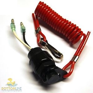

Another option is to use a boat kill switch with a Lanyard.
http://www.ebay.com/itm/YAMAHA-Outb...88-82575-01-/181759297756?hash=item2a51b2c8dc

You could opt for what the boaters have on the outboard motor control.
You have a tether which you clip to yourself and the other end is over a simple toggle switch.
Pull on the tether, such as when falling out of the boat, and the toggle switch goes off. Cheap and effective....as long as you hock yourself to the toggle.
Seadoo's and other PWC's have similar tethers but they are tied into the electronics and not practical to retrofit,
Dave M7040
Yes, that is what I referred to above.
Simple and if you do not want to use it you can leave it off.
You can stand up and not kill the engine.
Or make a big rip cord to grab as you fly off:eek:
