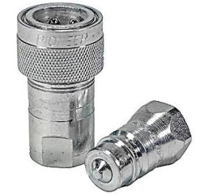

I have the Pioneer ”quick couplers” ….. (4000 series I believe which has a ball tip instead of the “tit” shown)………..and ran into the same problem. Despite relieving the pressure on the shut-down tractor (wiggling the FEL joystick)…. I still couldn’t get those damn things to re-connect….. UNTIL … I “hit” the little ball on the male couplers with a hammer to relieve the pressure on the mower. THEN it was a piece of cake.
I suspect that the flat couplers will need to be depressed with a screwdriver or such.
I suspect that the flat couplers will need to be depressed with a screwdriver or such. View attachment 157501
I've only had to do this once, and I learned to either put a rag over the male connector before whacking it or else be *really* mindful of which way it's pointed because the fluid sprays out pretty impressively.
Mine look like those. I put my grapple on this morning and right after pushing down the fel quick connect levers the hyrdos plugged right in..... WITH the tractor running AND EVEN with the fel up in the air. Amazing. 80% of the time it's a piece of cake. 20% of the time it's a bitch.
