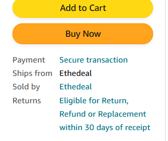

I went to the link you provided and found the info I was looking for.
IMO it appears to be one of hundreds of chinese companies on Amazon, Ebay and whatever.
I can't recall all the details, but our gov't opened up this market to china a while ago without much oversight or rule-following.
Something else to consider is recently I purchased some bushings for my L35 from Messicks and they had "Made in China" stickers on them.
Let's see if anyone on the forum has purchased kits like this and hopefully will have some good results.
Here's a Youtube by Den of Tools on one of these chinese companies. I have some products from Vevor and what I have works well. But this isn't meant to be a suggestion to purchase.
