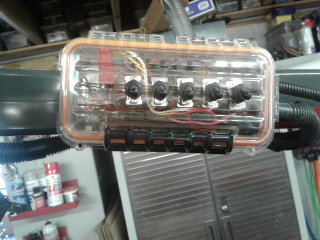

Whole setup draws under 20 amps and uses 4 relays plus one relay switched to the 10 amp fuse red/yellow wire in the fuse box to power up the relay solenoids and illuminated switches.
4 latching switches control the 6 lights.

Hey Jay any chance of posting more pics of your switches and wiring job? I am also going to be putting lights in did what model tractor is this and did you upgrade the alternator?

Electrical is a 10 circuit fuse block from NAPA. Using 5 circuits, other side spare fuses, mounted in waterproof box and 2 95 pull magnets from Harbor Freight.
