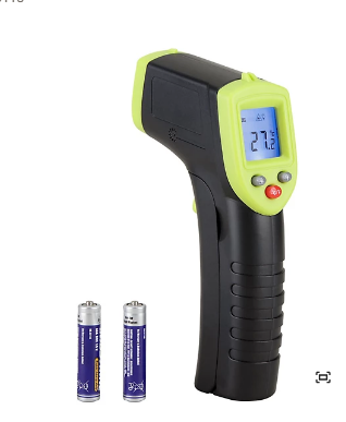

get one of these - 20 dollar item
great to see what is hot and what needs to be!
14,697
7,205
One of the handiest tools to have! Use it to see what cylinder is not firing. How the heating coils in the ceiling are working, is the AC condenser motor overheating, what is the temp at the AC registers, what's the temperature of the water coming out of the well .....

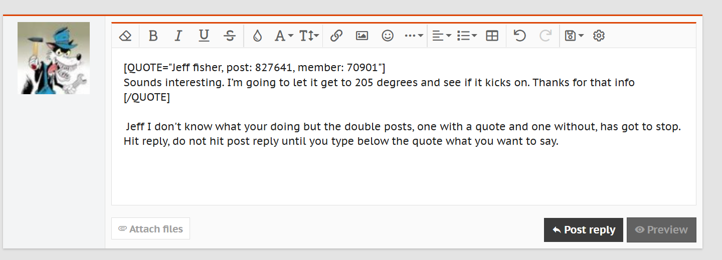

Jeff I don't know what your doing but the double posts, one with a quote and one without, has got to stop.
Hit reply, do not hit post reply until you type below the quote what you want to say.
Just like below:
